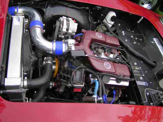

          Actually, I really like the looks of the MPFI manifold & throttle body, my issue is with the MAF sensor, the tubing needed to connect it to the throttle body, and and to a lesser extent all the ECU related wiring. I'd not even consider getting rid of the MPFI set up if I could get rid of the MAF sensor, and just put an air cleaner directly on the throttle body.

            You can keep the wiring and mess to a minimum. Here is a 3.4 I mounted in an old MG chassis.
