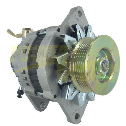

ID:	377556Lots of ford diesels have belt driven pumps on them, that should be dead easy. Some Isuzu diesels had vacuum pumps built ont he rear of the alternator also. Larry
                      http://www.ebay.com/itm/ALTERNATOR-I...ht_4483wt_1161
