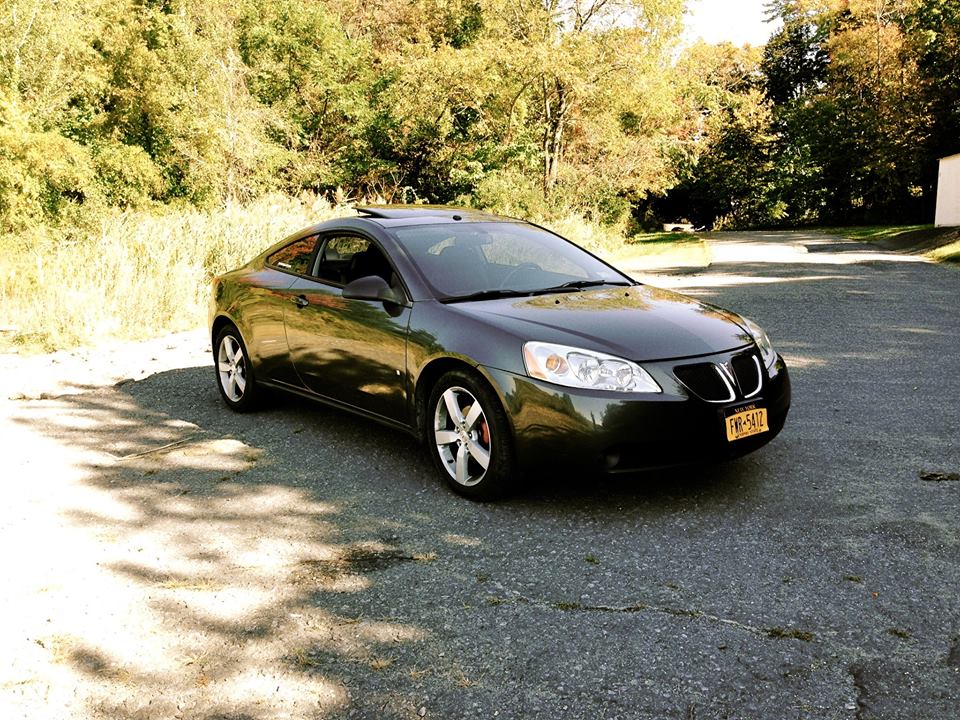

    Hello everyone,
    New to the forum,my name is Mike.I have 2007 Pontiac G6 GT with a LZ9 and the 6 speed F40 trans, Over the next few months I will be buying parts to turbo the G6. I will be will be doing a daily driving application for the car at around 4-6psi, and for drag set up days change it up to 10-12 psi. As for the turbo I am looking at a T04e but I think that it is to small, So i was looking to see what sizes people have used.Other then main turbo components I will be upgrading the throttle body, porting the intake manifold, and gasket matching the intake and exhaust gaskets on the heads, also most likely doing methanol injection. Only thing I have cannot find yet is upgraded injectors the stocks are #28 @ 58psi and have a static flow rate of 27.7lbs/hr. If anyone could help me with sizing for the turbo and help with the injectors that would be awesome. Click image for larger version
