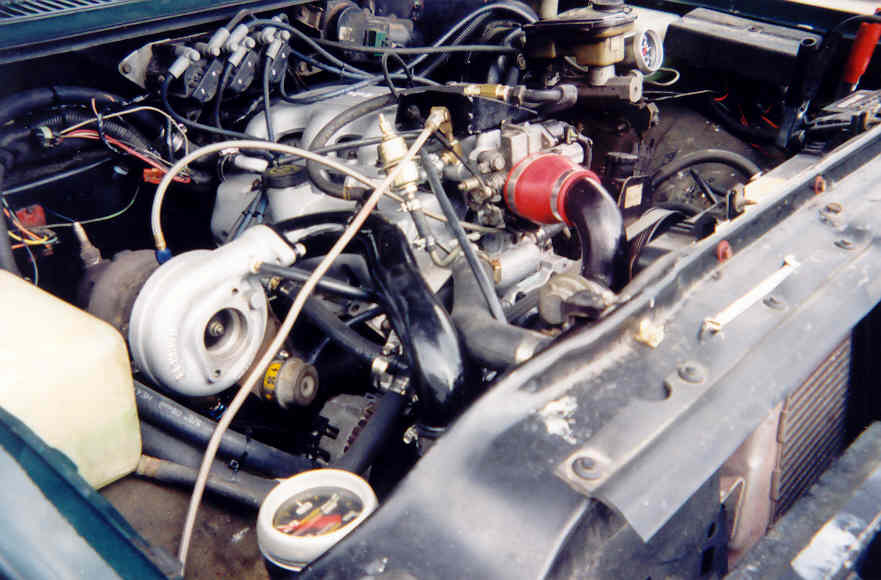

                        Ummm, no...
                        Take a look at the pic in the first post. The collectors will be near the bottom of the block, which is below the upper portion of the crossmember (the part that will be the issue) and the primaries will hit the engine mounts, since the mounts sit very far forward on the block.
                        I would not buy ANY N/A headers with the idea of turning them around to feed a front mounted turbo, well at least no N/A S-series header.
                        I built some headers for my S-15 jimmy many years ago and the driver side had a very similar layout, as far as where the collector was, and there was NO way that it would have fit on the passenger side and forward, the collector would have been in the same space or slightly forward of the engine mount, and then pointed very nearly at the steering linkage.
                        Besides all of that, you don't need to point the headers/manifolds forward in an S-series to install a turbo. I ran the driver side under the trans, as it would have been normally and then up to the passenger side header, and mounted the turbo on the passenger side of the engine bay.
