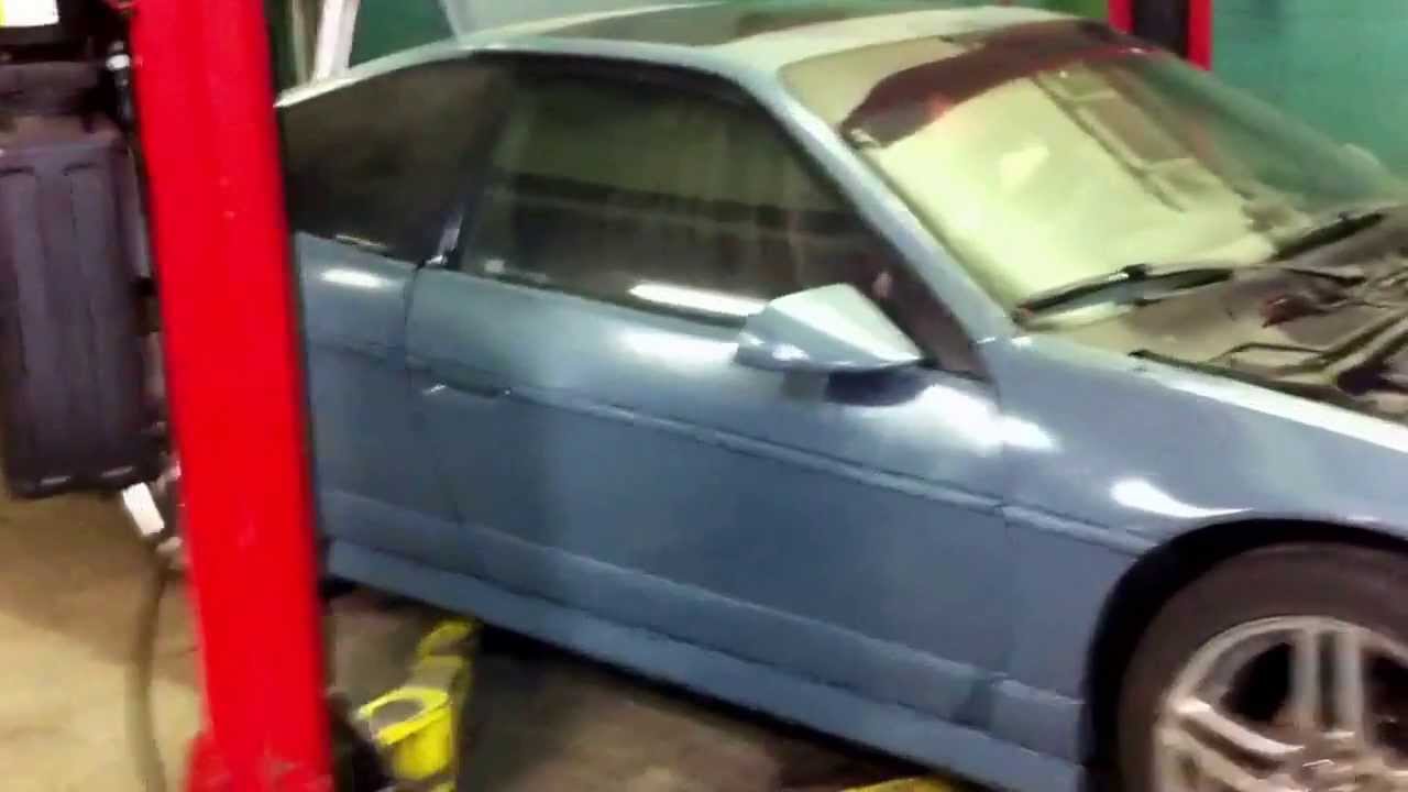

                            Ok so finally the overheating problem is fixed. I'm not sure what fixed it but it isn't overheating anymore at least.
                            First I did a compression test which checked out fine. Then I removed the thermostat, put the housing back on, put a garden hose attachment on a heater core line, popped the rad cap off and ran water through the system for a while. Also ran it out the surge tank as well. So it basically got completely flushed. Next I started it and ran it till it warmed up (without the t-stat) and it heated up till the fan came on and then cooled back down.
                            After that I put the t-stat back in, filled it with some coolant this time and reconnected the heater core lines normally. I ran it to operating temp again and the rad fan came on and it didn't start overheating. So that's a relief.
                            However it's still not quite where it used to be. It's doing this odd thing at idle where the temp will rise past halfway on the gauge and pretty much stay there. However if I rev the engine to 3k or so the temp plummets instantly to about 1/4 gauge. I do not think this behaviour is normal but I'm happy it's not overheating and I'm thinking it could just be some leftover air pockets needing to be purged (and as the WP spins faster it moves them through the system).
                            In any case, the next step for the car is an alignment and then I will finally put plates on it and begin really working on the tune.
                            Did a fastback swap to it/painted it, poly bushed the front and rear control arms, and built DIY coilovers on the rear. All I can say is WOW the poly control arm bushings made a HUGE improvement in handling even without an alignment. Car feels WAY more connected to the road now.
