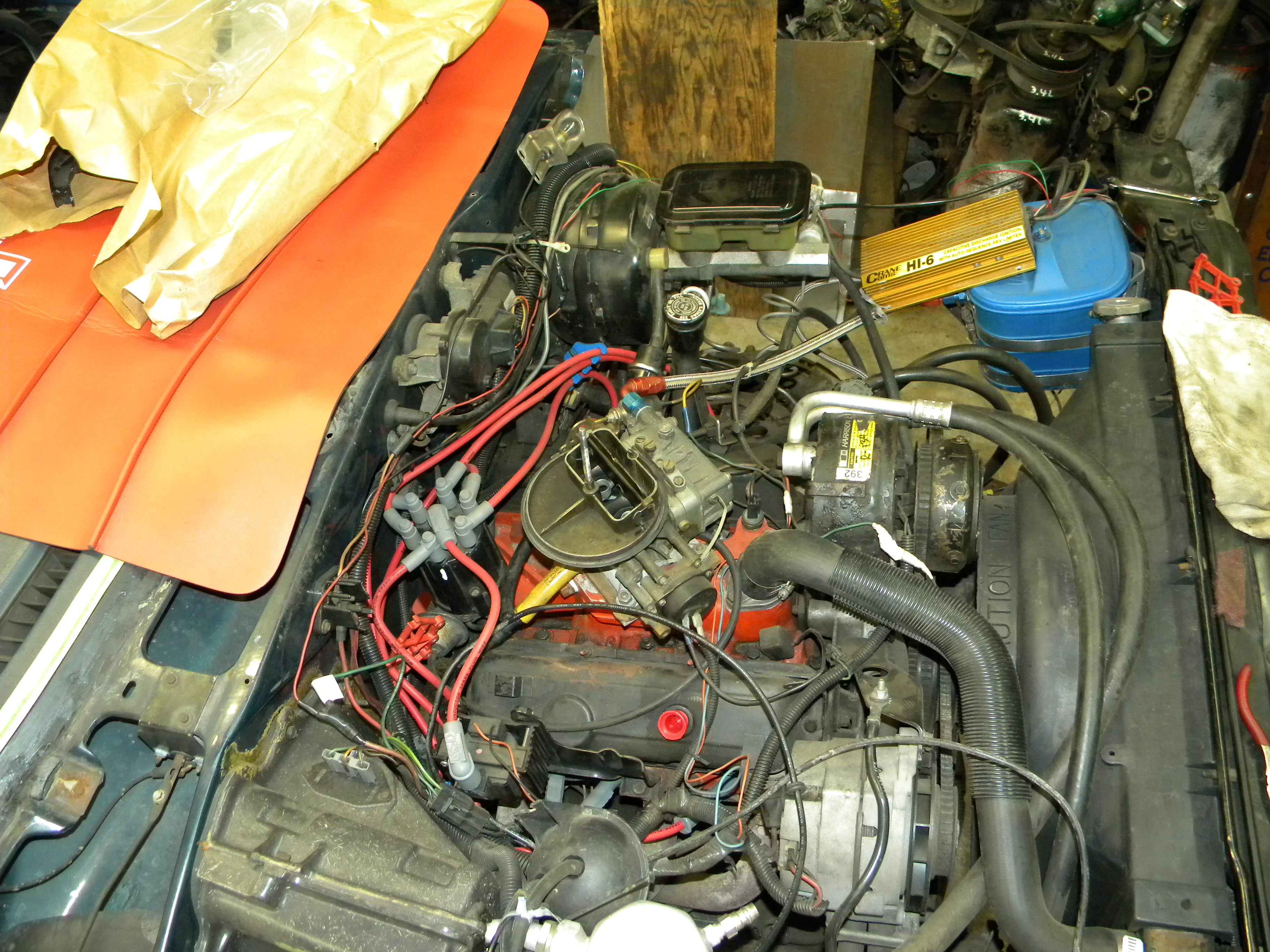

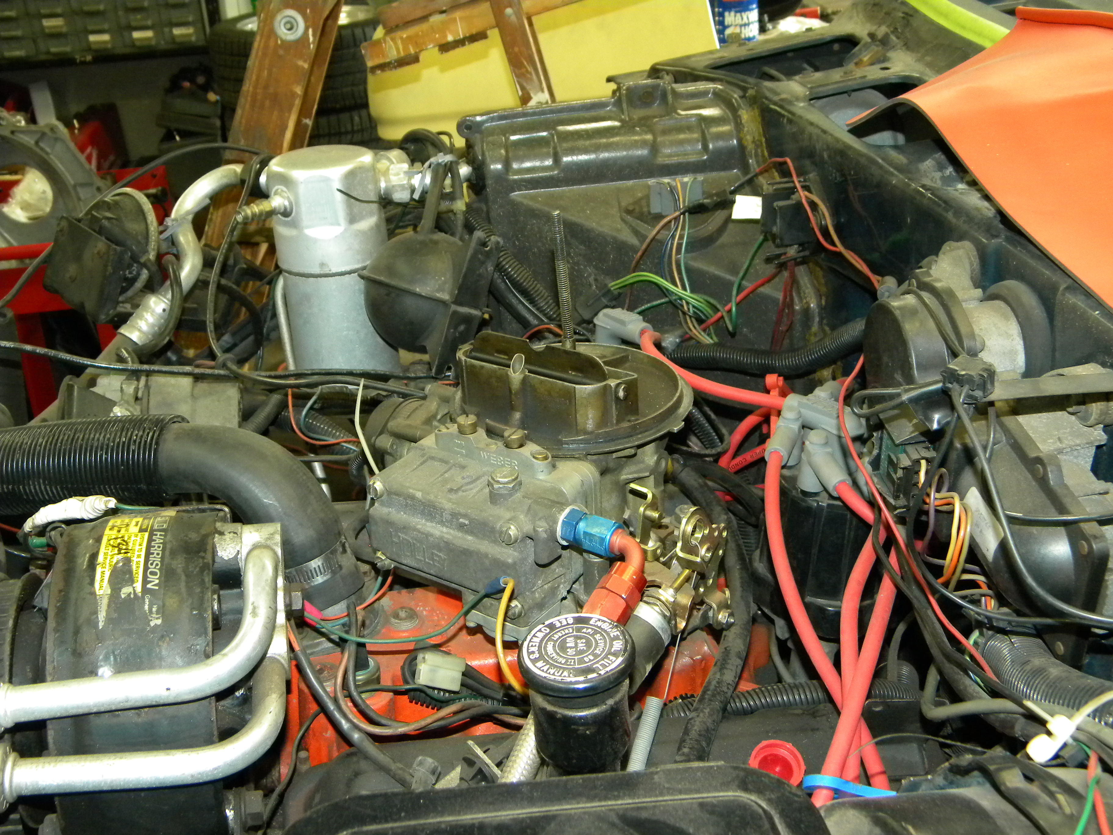

                        • 666Racing
                          • Feb 2010
                          • 18
                          • Zandoz
                            • May 2012
                            • 63
                            Originally posted by 666Racing View Post
                            [ATTACH=CONFIG]8178[/ATTACH]
                            What Version of carb is that? Is it mounted on a TBI manifold?
                            • 666Racing
                              • Feb 2010
                              • 18
                              2.8L with Holley & TBI intake
                              4412 Holley 500cfm on a modified TBI intake
                              Crower mechanical cam 248@.050 .479lift Intake
                              Crane roller rockers & CD ignition
                              5spd 4WD 3.73 axels short bed pick-up
                              I did not have good luck with the edelbrock manifold for my hill climb truck.
                              The eddy is way down on WOT power compared to the modified TBI intake.
                              - 3 ports on the eddy are half-sized to boost towing torque
                              I needed WOT power, not towing mid-range for my application
