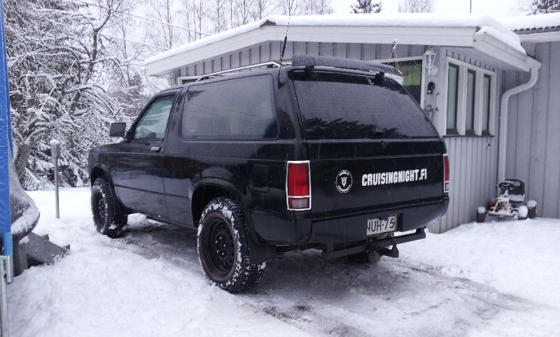

    I'm planning to swap a 3.1 v6 from grand prix to my 2.8L s10 blazer.
    Is the 3.1 internal or external balanced? I have a manual trans and I want to keep it and the grand prix is auto so I need to use the old 2.8 flywheel, if it even bolts on?
    Another thing is the engine mounts, does the FWD engine have same mounting positions in the block? Does the 3.1 accept the same rollertip 1.6 ratio rocker arms than the 2.8?
    Is there a intake for the 3.1 to accept tbi throttlebody ?
    Anything else to think about?
    Thanks!
