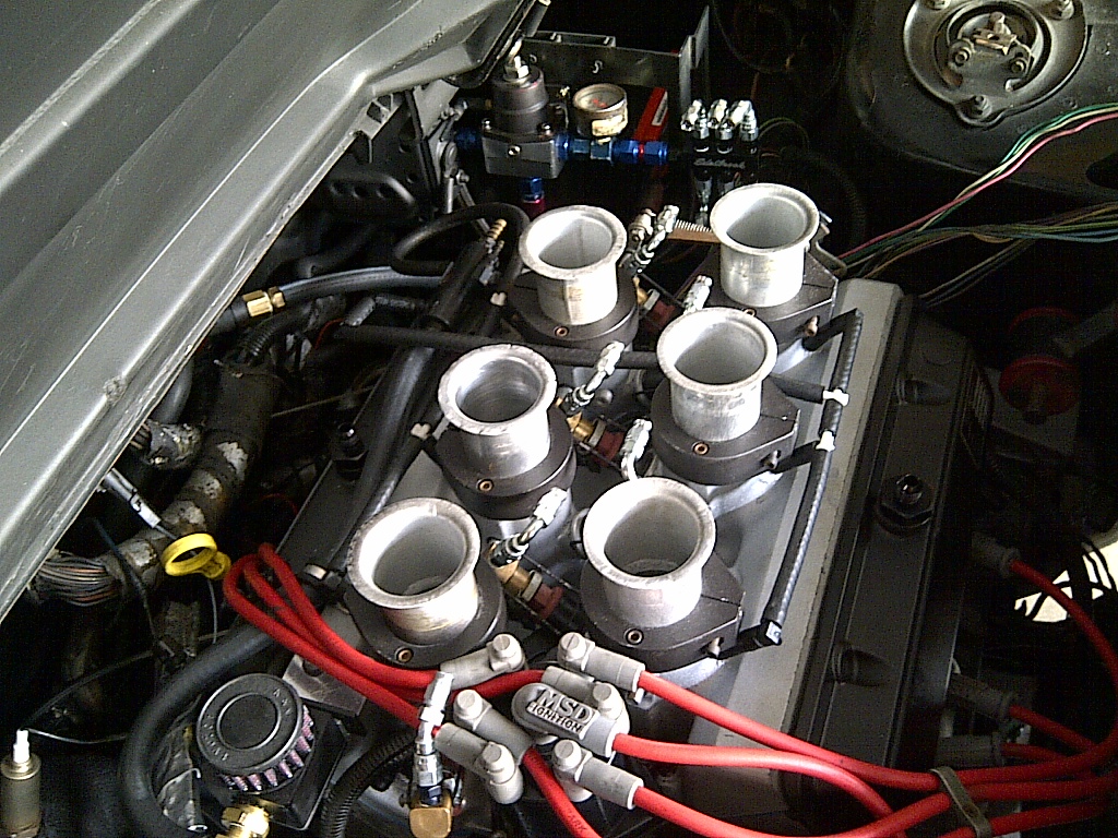

    I did an ITB setup on a lx9 bottom end. All custom.

      I thought the lz4 fit, flow more and had the same size throttle body? Your throttle body set up is very cool

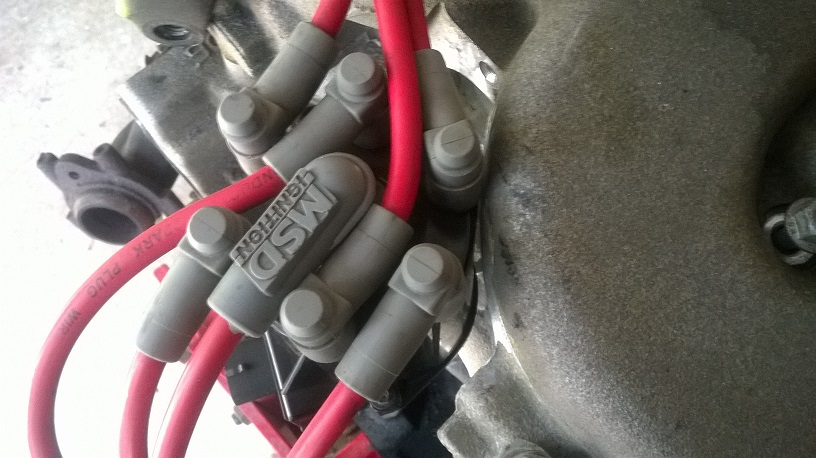

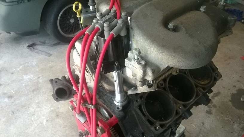

                    A dizzy wont physically fit behind the intake. .
                    Yes and no.
                    A modified distributor with a longer shaft will clear the lz9 upper intake wiith a smidge of grinding on the intake. I modified this one and it does work and the engine runs. I tested it. A stock dizzy won't clear the lower intake as it interferes with the runner.

                    it will not clear the lz4 though without cutting and welding of the lz4.
