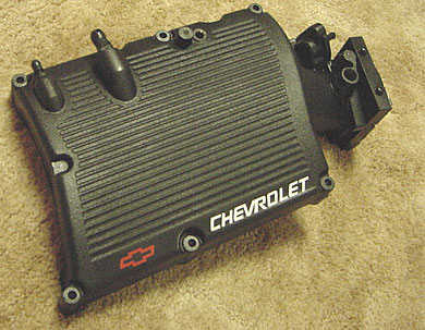

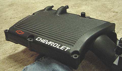

                      #70
                      I got it painted. It will look even better when on the engine. Tell me what you think:
                      More pictures and a description of what was done to it can be found here:
                      For all you 3500 haters that say it looks ugly, you got nothing on this. I think I made it look really good. Once I have it on my motor with the other parts painted black, it will look hot! But here is pictures now, looking good all by itself! :pimp: To help clean up the look of the manifold...
                      -Isaac
                        • 9185
                        #71
                        That looks pretty sweet IMO.

                          #72
                          Thanks Brad!!

                            #73
                            -Isaac
                            lookin real good couldn't even pm me the link on v6

                              #74
                              Heh I was going to but figured you'd see it at either place since you check in probably as much as I do.

                                #75
                                Nice man! I may end up painting mine black too, since the lower manifold, and valve covers are also painted black.
