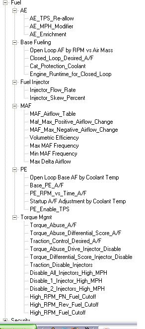

        here is everything you can change with DHP under "Fuel"

            Originally posted by onefastV6 View Post
            DHP also has the following under the Accessories tab,
            IAC_Idle_RPM_Trans_Not_Engaged
            IAC_Idle_RPM_Trans_Engaged
            yea i forgot about those two.
            and its actually
            IAC_Desired_Idle_RPM_Trans_Not_Engaged
            IAC_Desired_Idle_RPM_Trans_Engaged
            not to be nit picky or anything lol
                That's not everything. But not all of the model years have this function.
                Your local OBDII moderator
                2000 Grand Am GT w/ WOT parts
