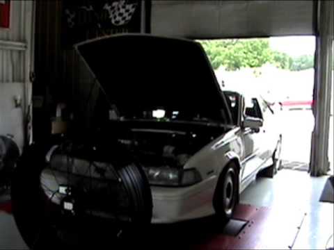

          Here is my Z24, you can hear me shift up to 3rd, hold at 2500 and then go WOT.
