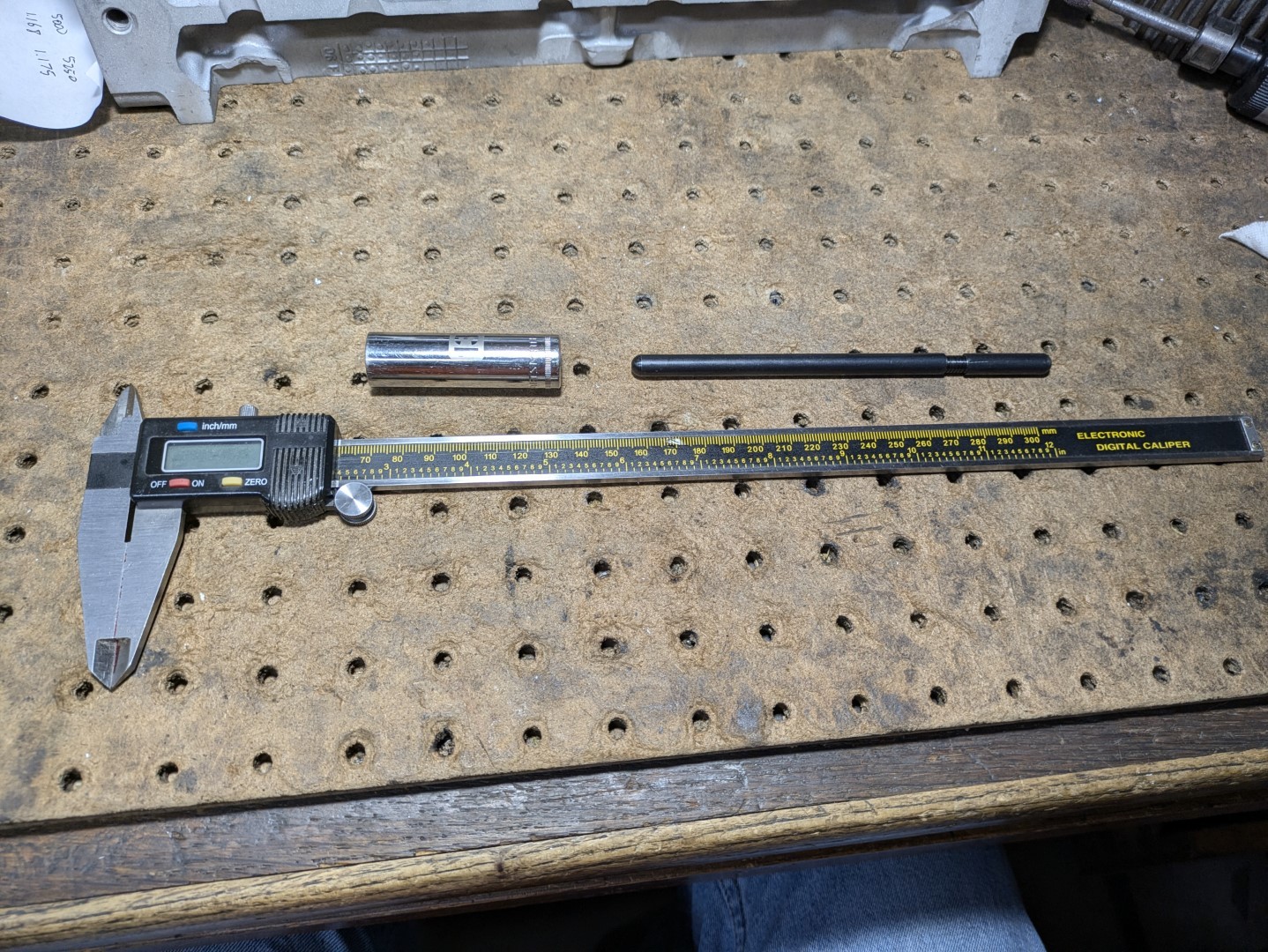

Besides the adjustable pushrod, you will need a 12" caliper or other accurate measuring device that is accurate to .001", and a socker for the nut/stud holding the rocker down. For this example, we are using a Gen 2 2.8 V6 with flat tappet cam and pushrod guideplates. The nut holding the rocker is 13mm
