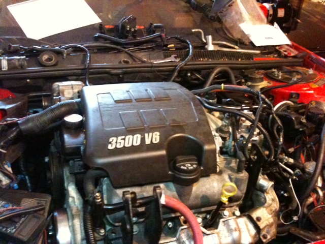

    IT RUNS. Finally, I started it up. I just couldn't wait anymore and there is LOTS left to do but all the essentials were there to make it run. I didn't burn the LX9 bin I have yet but it fired right up on the dohc code. Don't have the tach wire hooked up so I couldn't say where the revs were for sure but it sounded to run a bit high, granted the IAC is set to start a LQ1 with a lope and I just capped off the brake booster port and TB vac connections so I may have had a small vac leak. No exhaust on it yet so this thing was pretty loud! Other than that it sounded smooth, didn't smoke, and fired up on the first try. No immediate CEL but I ran it for only a matter of a few seconds, literally, because it didnt have any water in it. I still have lots of odds and ends to finish up and I really want to redo the wire looms - I bought some OEM grade non-adhesive wire harness tape on ebay so I'm waiting on that as well.
    Anyway, some pics as promised.
ID:	376605 Click image for larger version
ID:	376604 Click image for larger version

    I didnt forget! The pics are on my phone but I need to put them on a computer before I can post them and I can't do that here so it will have to wait till I get home tonight. I didn't think I'd like it but the LX9 looks good with the plastic 3500 engine cover. I trimmed the side flap off with an air-body saw to clear the power steering pump and it fits perfect.
