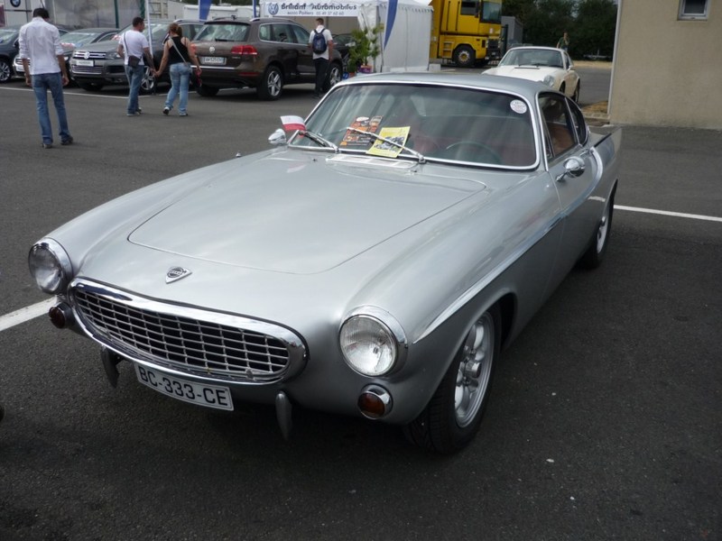

32" primaries... ain't gonna happenOriginally posted by SappySE107 View PostOk so I had to look up volvo 1800s.
[ATTACH=CONFIG]7756[/ATTACH]
Volvo makes me think
[ATTACH=CONFIG]7757[/ATTACH]
Ok, so...yeah id say that's not even in the ballpark of what I had in mind. Doesn't change what id recommend but now i wanna see pics of the one you are working with. The crossover is for sound, so its all up to you. Im only an expert because I know what other people have done as well as our own stuff. If you can do some custom equal length headers, then its going to be even more so (ask superdave on here). About 32" primaries ideally if you are ambitious.
The engine builder, who granted isn't familiar with these motors, popped some figures in and came up with 1 1/2", 34" primaries to 2.75" to 2.5" collectors... we looked at the Volvo, laughed at the length and thought the primaries looked too small; we better find some accurate VE and valve event tables for this sucker.
Yes, the P1800 isn't the boxy traditional Volvo; that being said, the TurboBricks and V8 swap (hello Paul Newman) guys can make those suckers move, and when done properly, can actually look great in a "so wrong it's right" sort of way.
