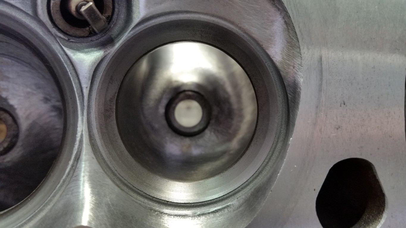

If you take your heads to a shop and have a valve job done, you very well could get something like this.
Then opened up the ID of the seat, and blended to the next angle once the width was better.

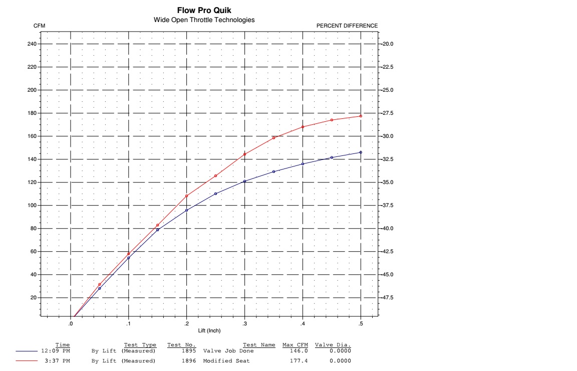

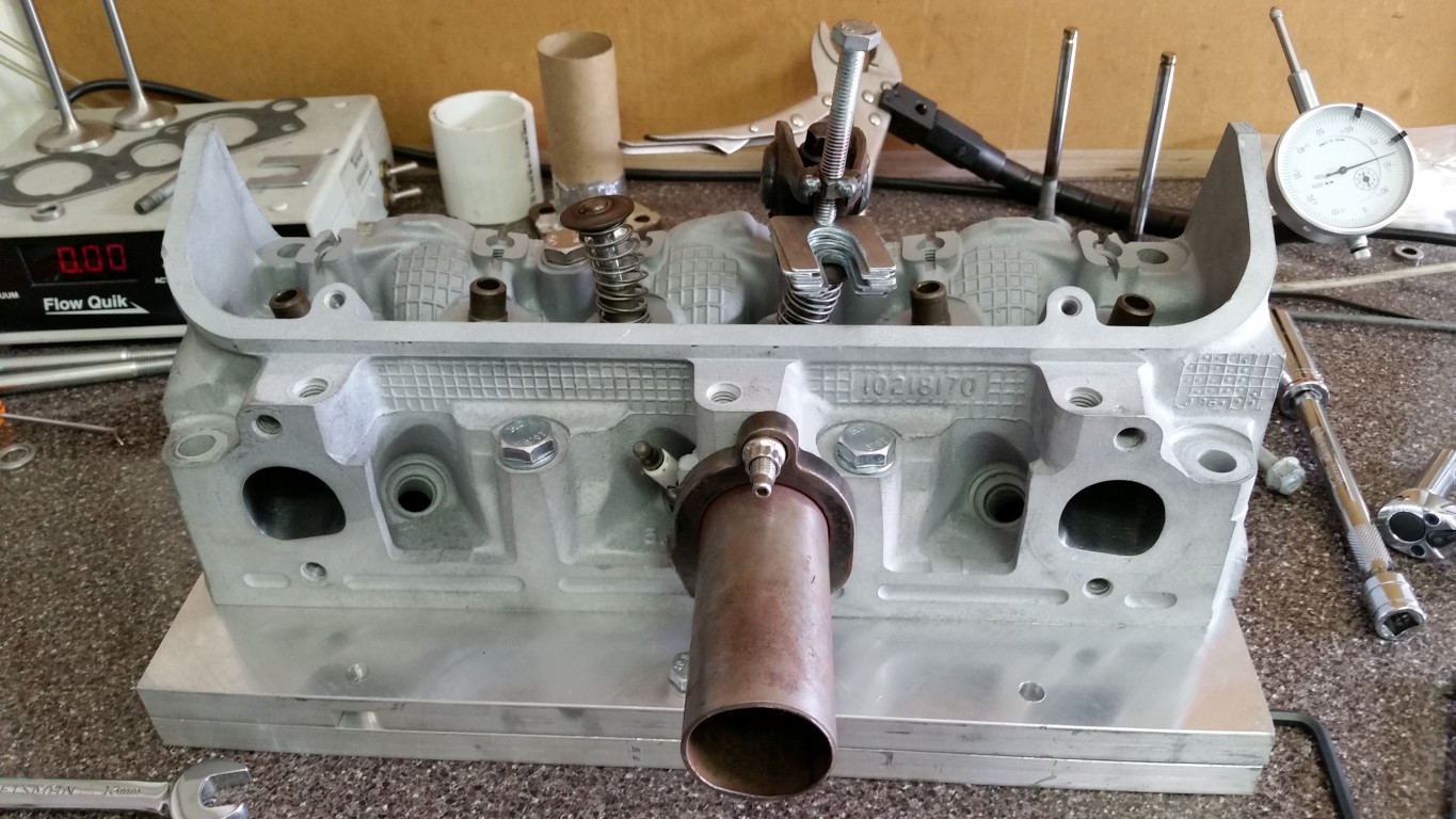

Flowbench testing
Results
