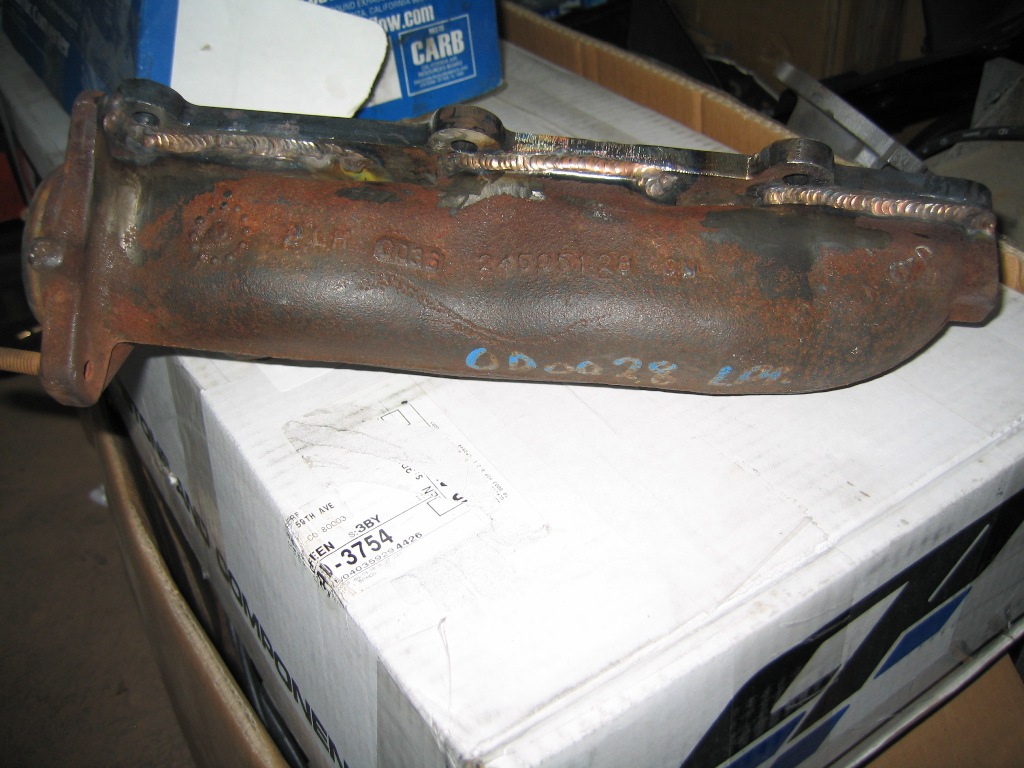

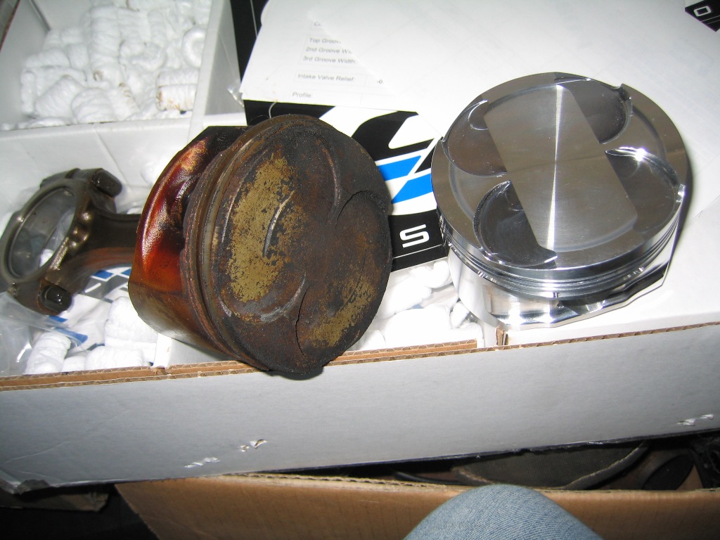

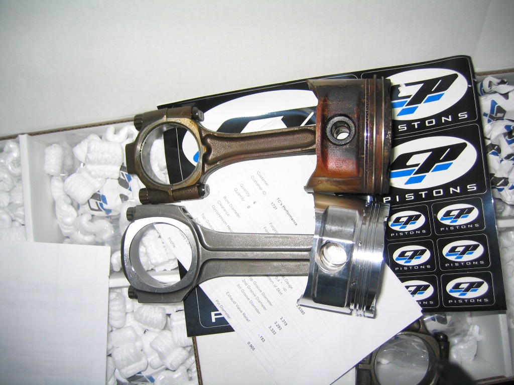

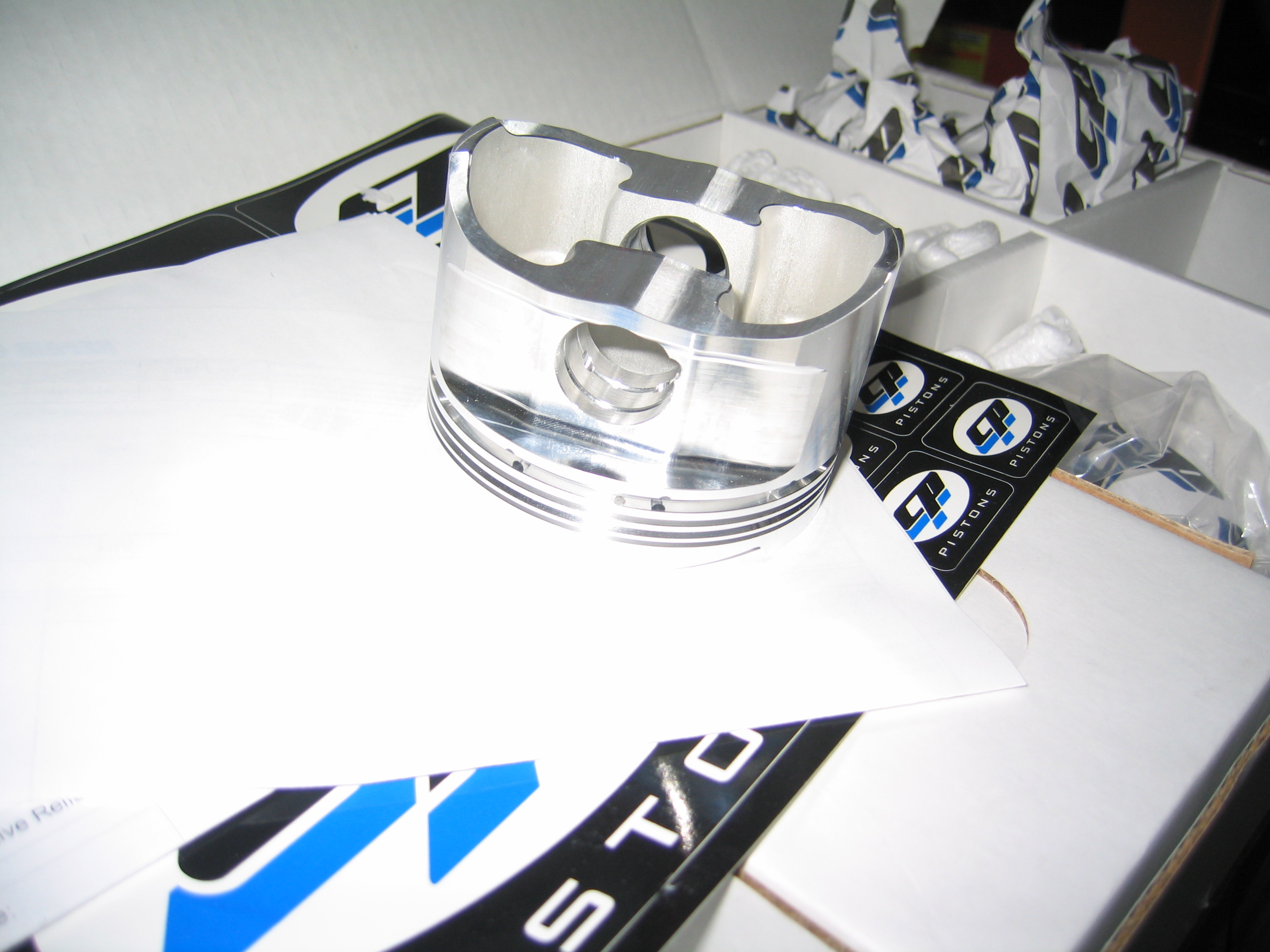

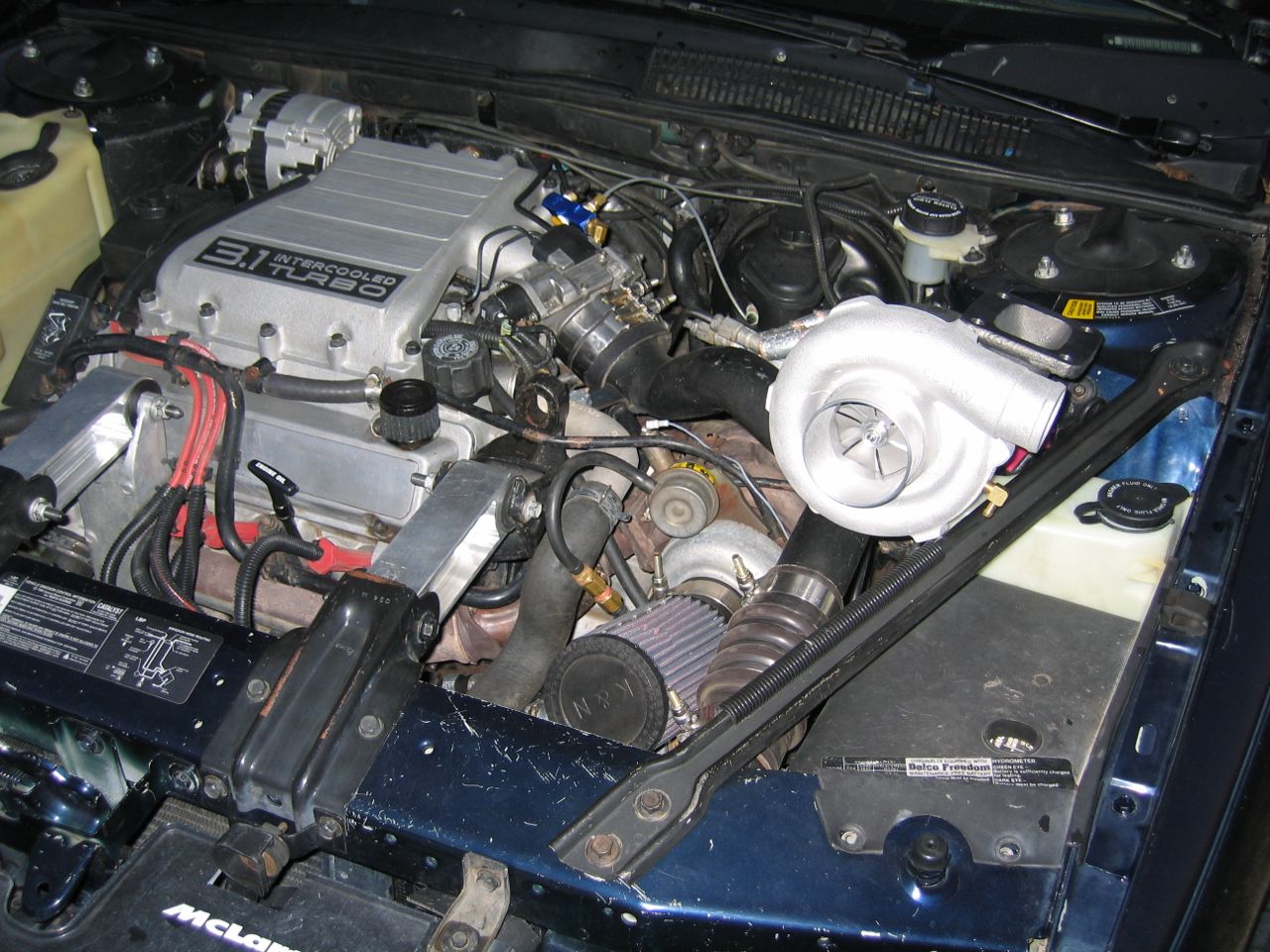

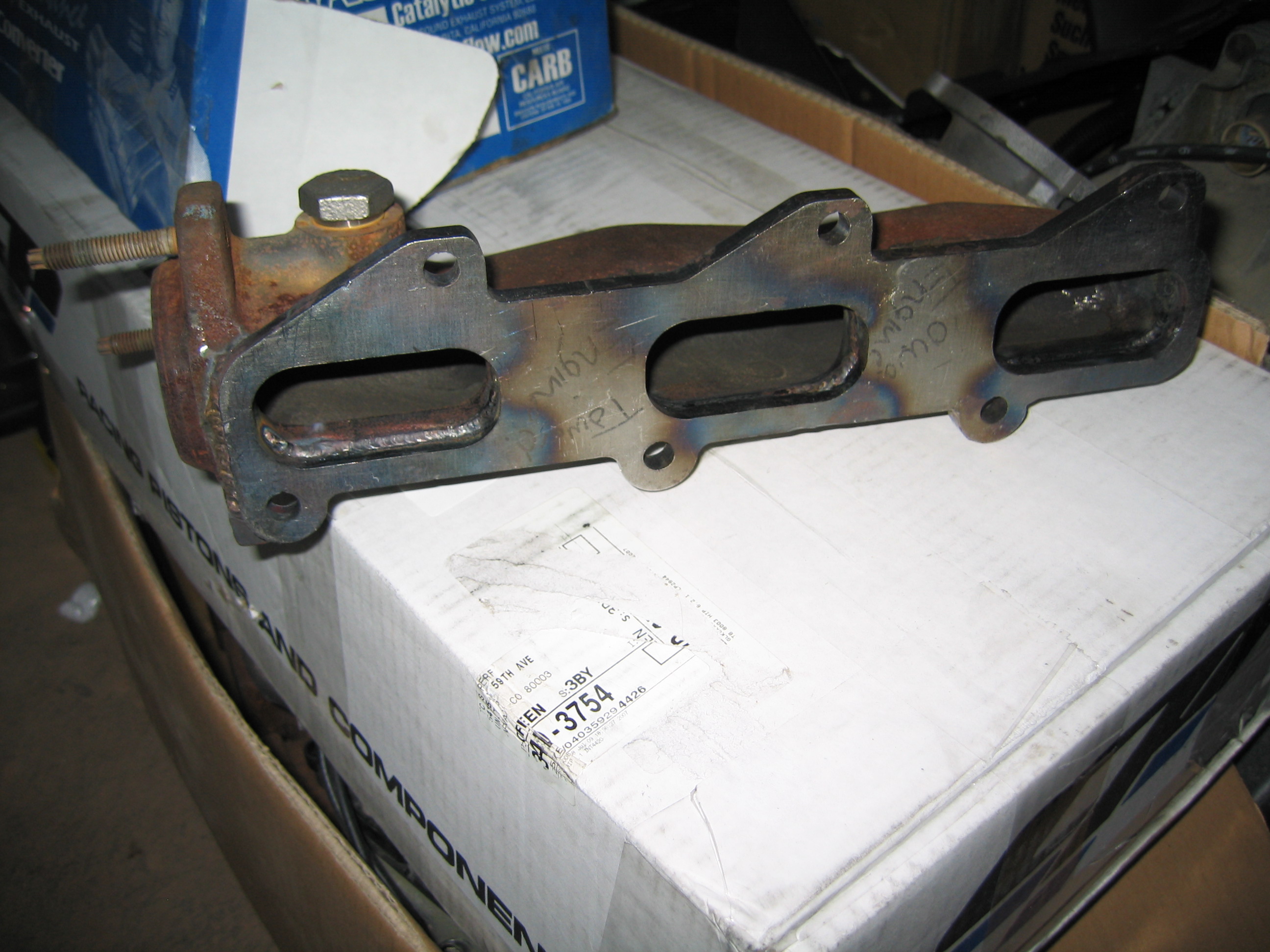

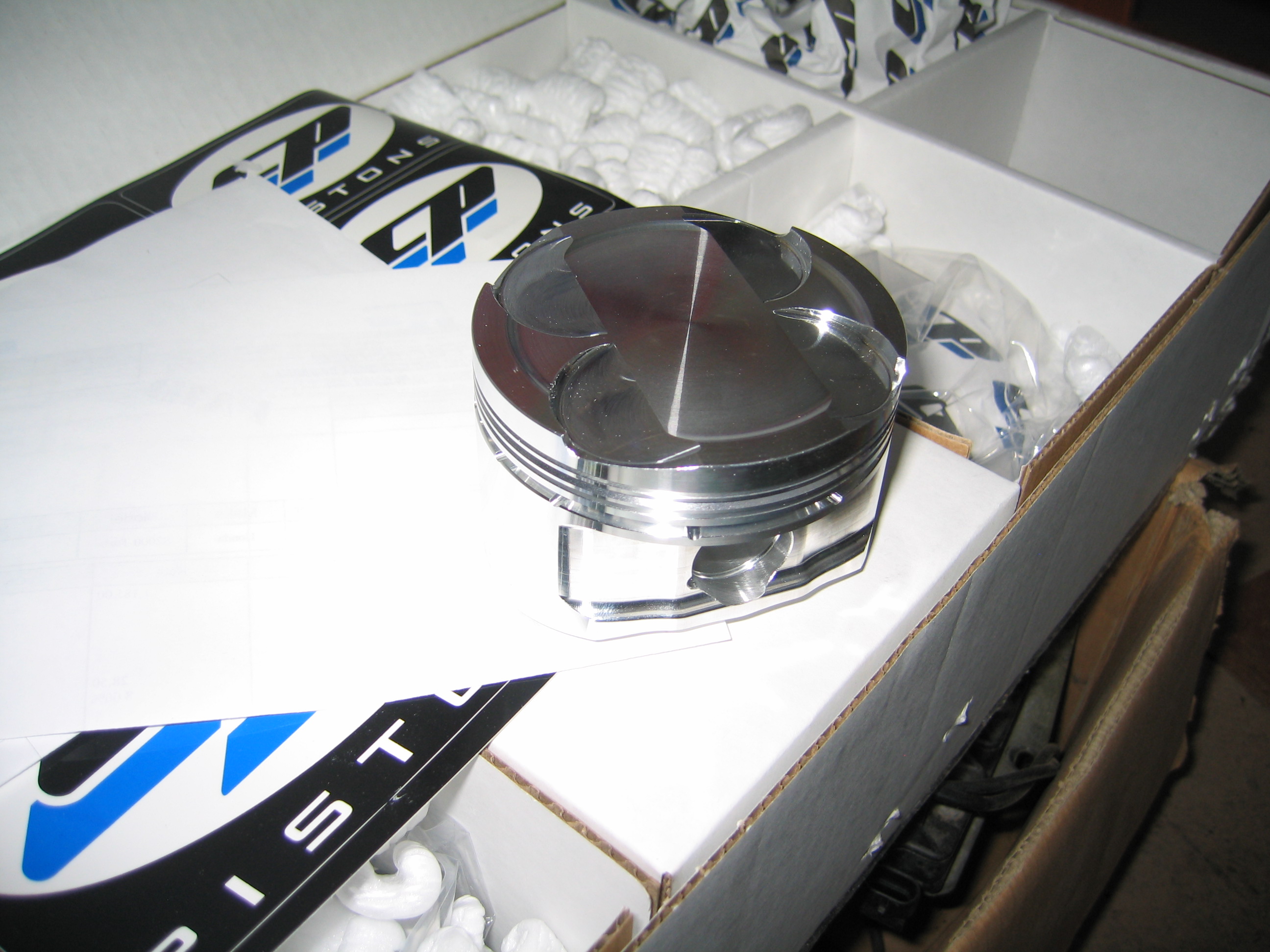

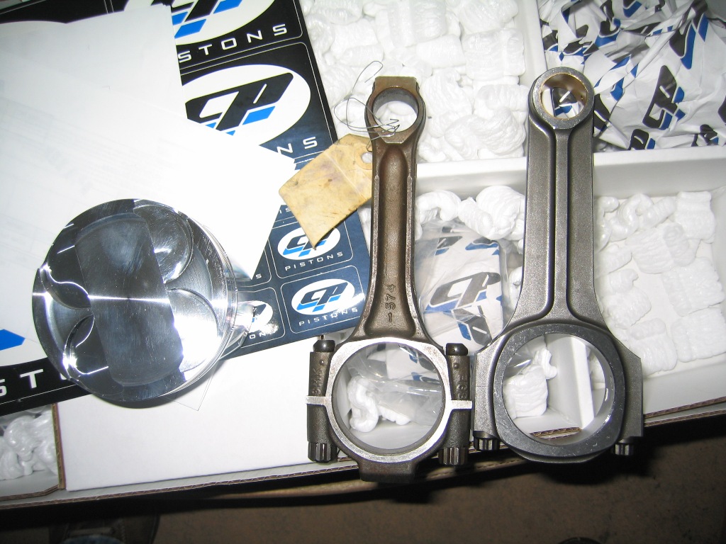

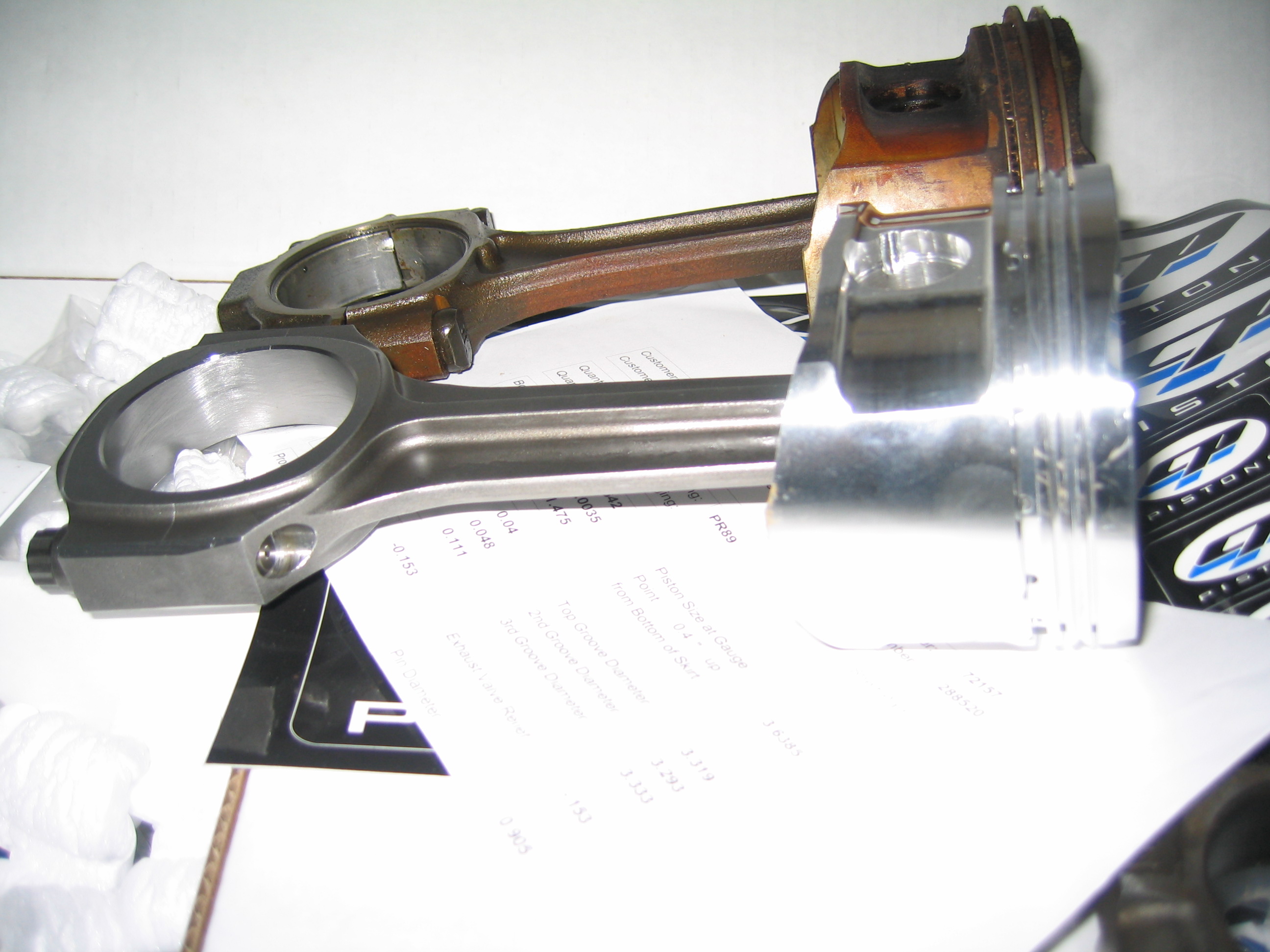

                            Anyway, here are some pictures of the new, old parts. Most have been posted before, but threads are worthless without pics. (The turbo in the first picture is a T67 compressor and P-trim T4 turbine with a dual ball bearing center section. It uses the small T04E compressor cover so it will swap directly in place of my current setup. The normal T67 compressor housing is HUGE and would require redoing the entire set of hot and cold turbo piping.)
