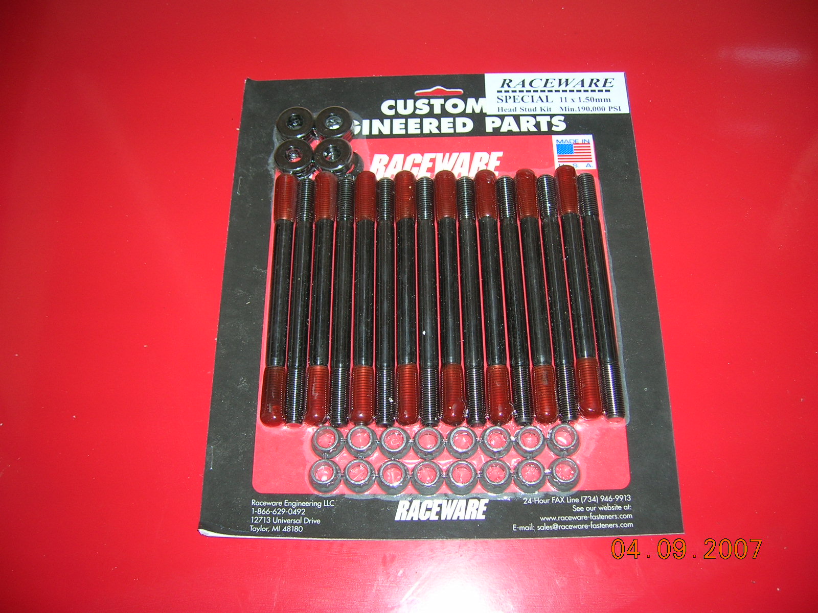

              • #97
                I used raceware's head studs for a M20 BMW, I had to call and order to get an extra 4 studs (and nuts and washer) as I recall. And I had to shorten them .200" to clear the cam carriers.
                [SIGPIC][/SIGPIC]
                Fiero gt 3.4 DOHC turbo forged bottom end MSII
                94 Ranger 2.3 turbo t5 (DD)
                • #98
                  We sell M20 head studs, and they won't fit a 60V6 block. M10 vs M11.
                  • #99
                    My apologies, I recalled wrong.. special ordered...Click image for larger version
                    [SIGPIC][/SIGPIC]
