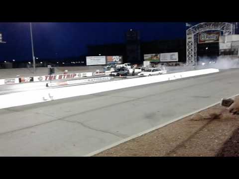

                    • Lightness + shorter front tires = over 1/2 second improvement in ET. No mechanical changes. Before and after.
                      Also, on today's edition of "Inappropriate Burnouts"...
                      Kaiser George IX: 1996 Buick Century Special wagon. 213-SFI. 238k miles. Never gonna give you up, never gonna let you down. First documented LX9 swap in an A-body! Click here to read my build thread!
