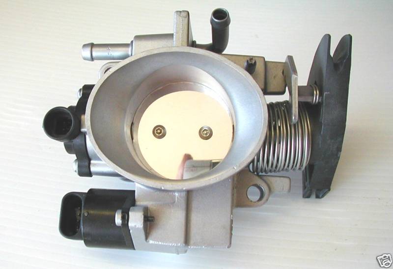

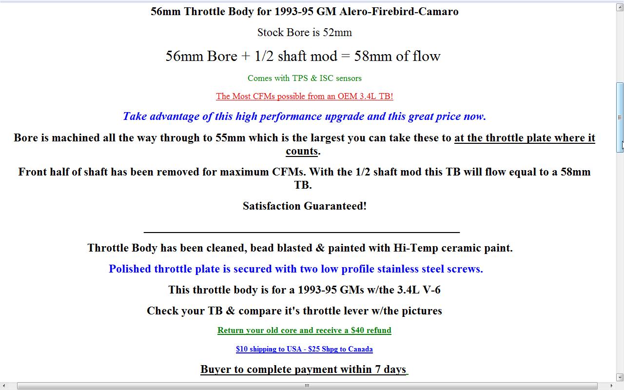

You sir, with your thumb up your ass. How would you like a really expensive and poorly marketed stock/bored throttle body? Its a 56mm throttle body, bored 55mm all the way through "where it counts" at the plate. Stock was 52, but we bored it to 55mm cause that is the most it will go. Nevermind those stock 56mm throttle bodies that work, this is bored and half the shaft is missing so it flows as much as a 58mm. Proven? FUCK NO! We don't deal with proof on ebay, we just make up some shit and you pay far out the ass for it. YEEHAW! Fits aleros, camaros, and firebirds. How is this possible? Magic.
Are you dumber than dumb?
I'd like to return my TCE 65mm unit to have the "half-shaft" mod done.
ROFL!!
BTW I have a 56mm unit bored and sleeved to 62mm that unfortunately DOESN'T have the "half-shaft" mod for sale for ALOT less than $210.00.Last edited by asylummotorsports; 07-08-2009, 11:34 AM.
hahaha 220 bucks
id like to return my 65mm tce all together. instead im gonna get this fine piece of work.
i should email them asking to see some pics with calipers in them to see the exact diameter. it looks like a stock tb with half the shaft missing.
hahaha just looked at the pic again it looks like they used the security torx screws. guess they dont want the average person that doesnt have the security bits to take the blade offLast edited by geldartb; 07-08-2009, 11:02 AM.sigpic

did anyone happen to notice that hes an old guy selling a bunch of these all modified like this to different extents?Last edited by no_doz; 07-08-2009, 12:50 PM.
on a side note i hope the poor bastard who buys that doesnt have an auto trans or his shit is going to always be given like 1/4 throttle & either he'll launch his car into a neighbors house or take it to a mechanic to findout whats wrong and get charged $600 for it
you forgot to mention the improvements in fuel economy though...
and manual or auto, its still going to have too much air flowing through at idle, meaning the IAC is probably going to close completely and still not idle right, which means there's going to be codes set AND it will run like shit...
i think i want one now

also the reason i made the 1/4 throttle comment is because the tb's purpose is to limit the flow of air into the engine, by opening the tb you are allowing in more air, your car's computer recognizes this & applies more fuel (air/fuel have to be ratioed properly, way too much or too little could result in your engine not running, and your car's computer is designed to keep this ratio to a specific setting), the result is bigger explosions & therefore more power.
when the tb is closed, its supposed to not allow much air in whatsoever, & the amount of gap between the flapper (probably not the proper term) and the walls of the tb itself should NOT be there-& is the equivalent of probably 20-25% throttle, & your car's computer is probably going to recognize that something is wrong and go into limp mode-run like crap-im not really sure-never tried it.
im sure one of these other fine gentlemen could offer you as to what response this may illicit from your car's computer (i doubt it will be a good one).Last edited by no_doz; 07-08-2009, 04:01 PM.
I am pretty sure that the TB in question includes a new throttle plate, so the stock gap is maintained. So therefore your theory is wrong.-Brad-
