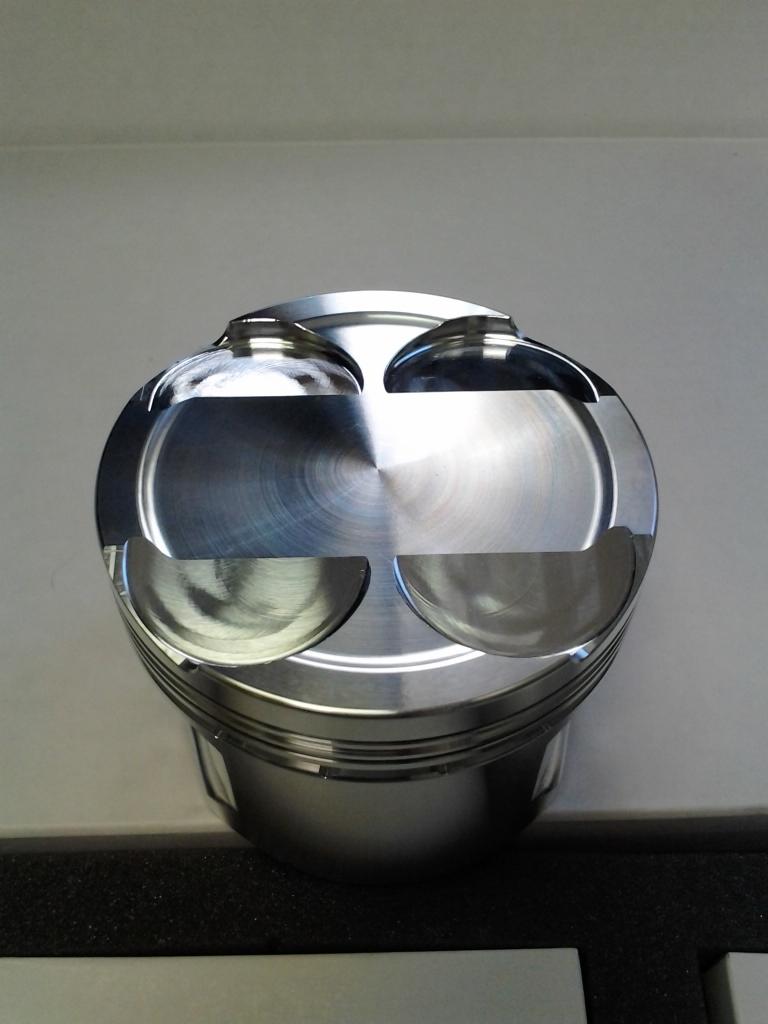

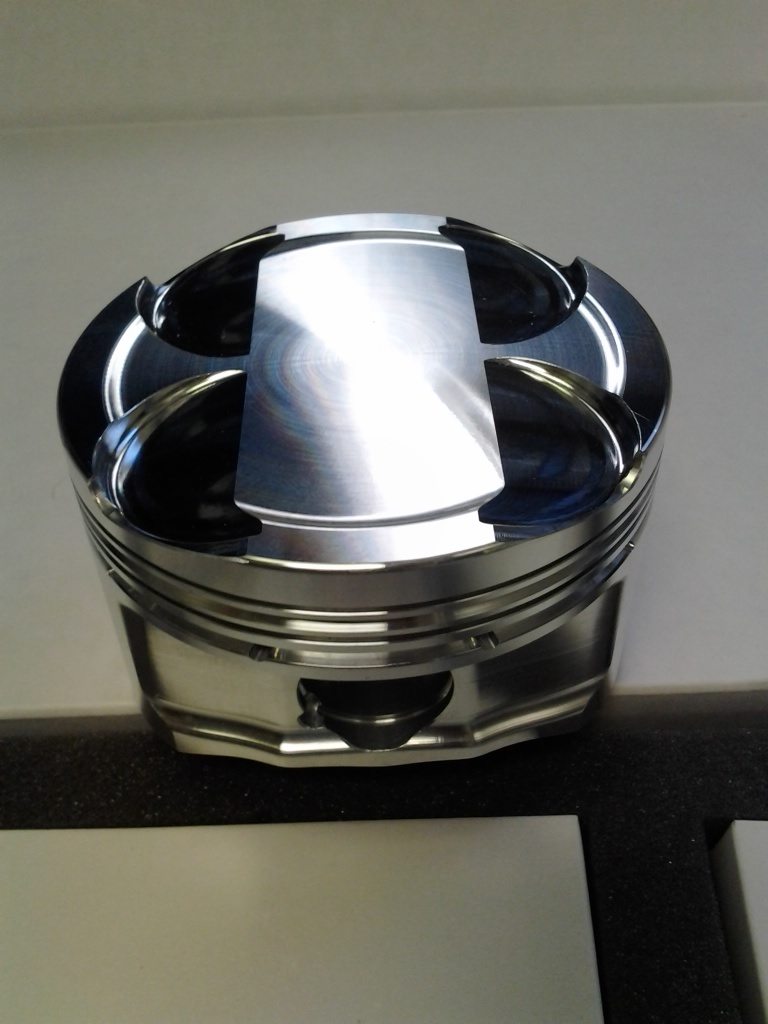

    I'd hang those on my wall they are so pretty... Screw getting them covered in oil and carbon.

    WOW! What a strange coincidence you ask today, because the forged pistons just arrived after a 3 month delay ("Uhhhhhmmm, we forgot to order them...") I know this will be good news to FerrariFan!

    Update. Forged Rods from WOT tech have arrived and custom forged pistons and plasma-moly rings have been ordered. I'll post as things progress.
