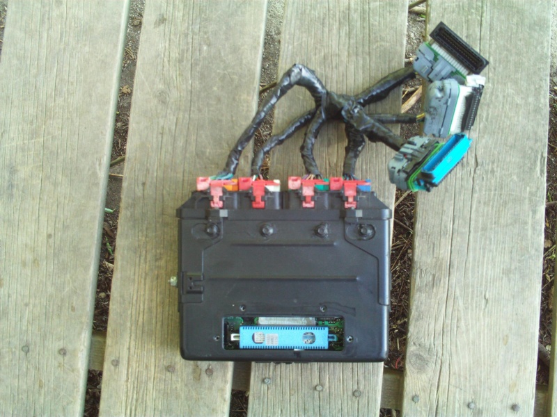

    for those that didn't get to follow along or didn't care to read through my conversion thread, i'll post a pic of my first one(even though i look back at it now and make a horrible face)...
    QUITE an improvement since then

    quite flexible, with the ~10+" of wiring that is between the OBD1 and OBD1.5 plugs, it gives you quite some room to work.
    i was trying to do the math necessary to perfectly match the A harness with the B and C harness but then you start dealing with a lot more issues and possibly having a really compact harness that could be sticking in places that you don't want...

    lol I like it Robert. It looks flexible too which is good since sometimes you have to "cram" in all the wiring to get the pcm to fit where it's supposed to.

    crappy lighting, but i just got this one finished..
    beats the inbread electrical-tape octupus i made before
