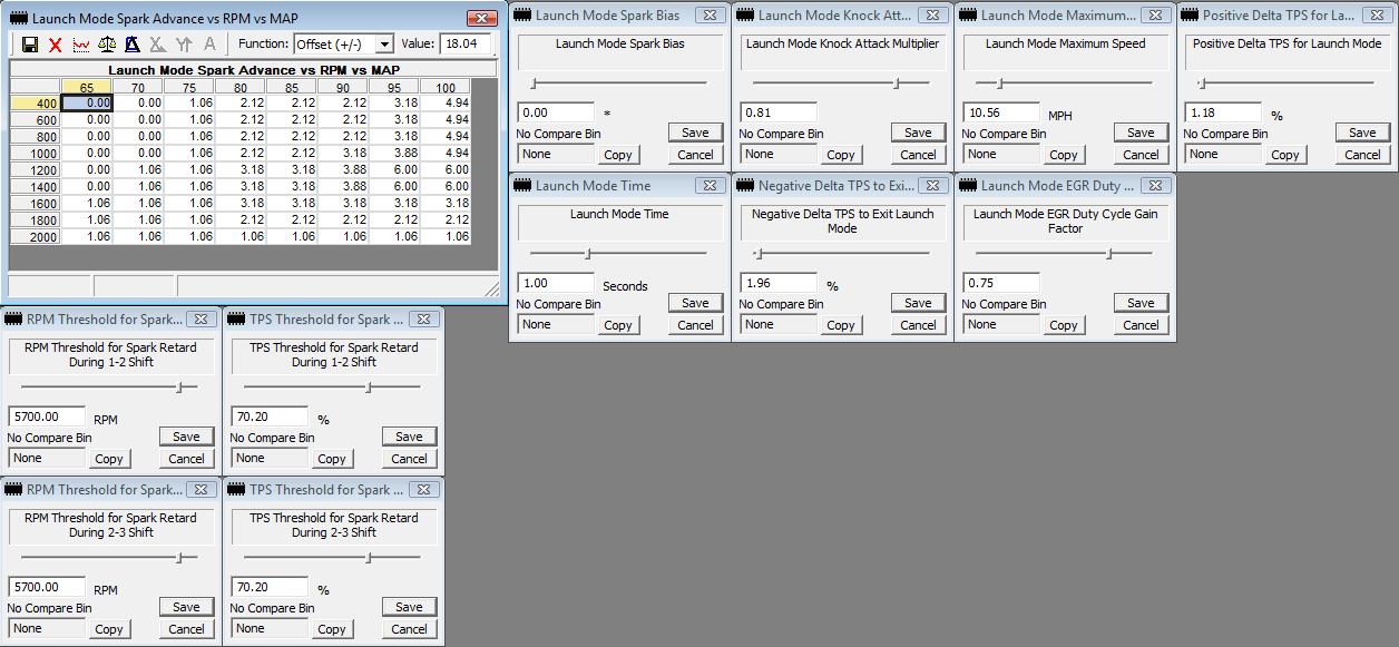

    Robert, A1 has launch control? Sweet. That was my only reason for wanting to run $DF on a 7730. It was either that or go to the modified TPI code for that feature. People that have gone to the TPI code say it idles better than A1.... Strange.
    I'll email you the stuff. Rodney is 3400beretta. (3500 turbo 282 beretta)
    if you can't get two fully hacked and very similar masks to run the same, you need to step back and realize what you're doing wrong...
    is that the same rodney that set up eric's car?
    and shows all of the torque management stuff that i put into my A1 XDF... if there's more in the code than that, i either didn't understand it or couldn't find it.
    obviously DF has a bit more complex stuff, but this should be simple enough to where anyone could understand it and use it effectively.
