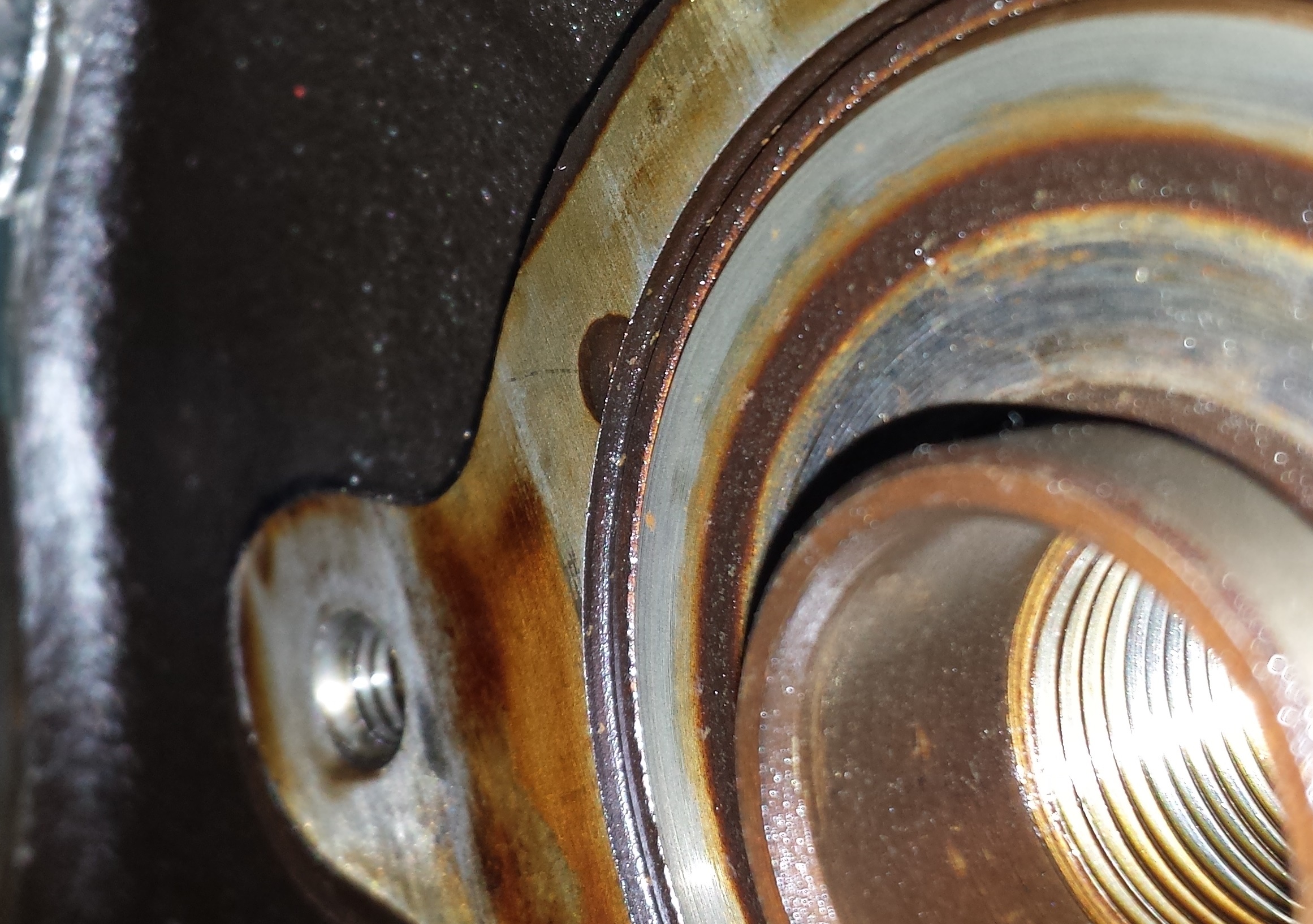

    Pics of an OEM 3100 setup
    you can see how the bearing is not flush with the block as Marc is suggesting to do when using the SBC bearings.
    Kinda wish I knew where mine was placed because I need to pull it all apart to verify if I want.
    Thanks for doing this, I need to pull mine apart so I can install the revised set and now I have another thing to look for.

    replied
    Leave a comment:
    replied
    It's only about .03 set back if that... That's what Marc measured on one of his. I'll have to check mine later I can post some pics after lunch though.
    Leave a comment:
    replied
    We drilled the 2nd hole in mine too, I can't remember if they were set back at all. I may have pictures but i'd have to look.
    Leave a comment:
    replied
    There probably wont be any "issues" per say but they may not last as long as the OEM setup since I did verify that the OEM bearing is set in just a bit from the block surface, also if you or the installer inadvertently set the bearing in from the block face then you corrected any possible issue.
