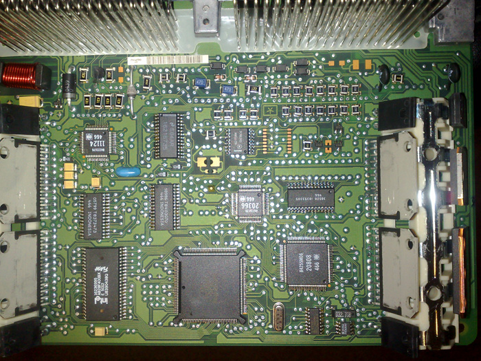

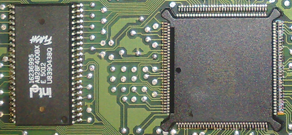

Well I opened up 2 Pcms last night
This is what I found
Flash Chips
2001 Impala 3400
1999 Chev Venture 3400Code:Intel 16236995 AB28F400BX E5012 U8390438Q
Not sure of the differences between the Two besides last to lines, but def same family (maybe build code dates etc?)Code:Intel 16236995 AB28F400BX H3311 U0490294Y
It seems MANY MANY GM Pcms use this chip (even back to 96 4.3l in trucks I have seen)
Searching for Data on this chip, I come up to referrences to
AB28F400BX with a T90 or B90 at the end? not sure what that would be?
Also have found
Part #: AB28F400BX-B90. Description: 4-MBIT 256K x16, 512K x8 BOOT BLOCK FLASH MEMORY FAMILY. File Size: 461.38 Kbytes. Manufacturer: Intel Corporation.
which seems to reference both B and T
Here is the image of the 99 VentureAs of April 2

planethax: i'm not surprised that GM uses the same FLASH chips over and over, since it costs money to re-engineer for different chips. the CPU is likely identical as well.
