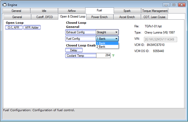

                Here is what I know so far......
                Using HPT Beta, the 97v6 controller w/ OSID 9355440
                In the Open & Closed Loop tab, there is an option for 1 or 2 bank o2 sensor config. But only available in the Beta version. I don't know where that would be in Tiny Tuners. The option above, Exhaust Config, is straight or dual out. I suppose that controls how many downstream O2's are used. As 1 bank straight or y is 1 rear o2. But 2 sensors upfront can have 1 or 2 rear o2's if there are twin or single catalytics used.
                I also noticed there are 3 sensors among 2 banks in the DTC list.
                bank 1 sensor 1
                bank 1 sensor 2
                bank 1 sensor 3
                bank 2 sensor 1
                bank 2 sensor 2
                bank 2 sensor 3
                What could possibly be the 3rd sensor? Could that be a wideband capable input? Dual O2 per bank?
                I can understand 2 sensors per bank with 2 banks. So I hope I helped but I think I probably introduced more questions then I tried to help answer, lol.
                EDIT: Possibly look up people throwing DTC p0151 (or other bank2s1 codes) to find which GM vehicles have dual front o2's. Then find out which ones use the same type of PCM. Then it is just a matter of getting the wire diagrams and pin outs for that particular vehicle.
                I am finding Chevy Silverado 2002 with the 5.3l as throwing p0151. It might be a big block thing. It might be a truck thing, I really don't know atm. But I am interested as well, i also want twin o2's and hopefully have twin catalytics down the road.
