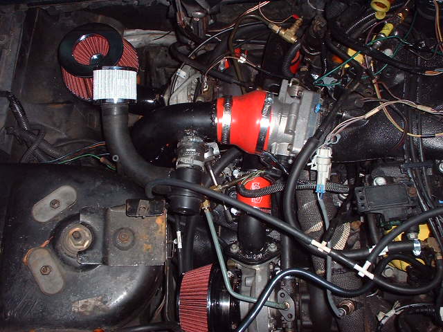

Guest repliedYes, it's not wise to run the blow-off valve without a filter unless you have one that somehow remains closed when not relieving pressure and has an air tight seal, otherwise you'll be sucking junk into the engine. In Atlanta the in the Spring the pollen count is rediculous and all over the engine.Originally posted by IsaacHayes View PostCool I was waiting for some updates! Looks like your TB coupler clamp isn't on too straight! Wow not much room for the filter on the rear turbo! I see you are using a filter on the BOV, most people don't which isn't a good idea.
Actually the forward filter sits the way it does because of a clearance issue, the aft has some more room available the way it is. I saw the TB coupler clamp when I posted the picture.
So far the corrections appear to be working fine, I thought I had a turbo problem but it looks like I was just burning off excess oil after the restrictor was installed since the remaned turbo appears to have stopped smoking.
Right now I'm have a problem with achieving a smooth acceleration; when the pedal is pressed the engine revs to about 3000rpm and cuts out to full lean on Zeitronix WBO2 data logger, if I pump the pedal it will rev so I have to find he table that's causing the problem and add fuel to it at that point.

Guest repliedBack at it. Corrected two oil leaks I hope, bled the brakes, added a central oil restrictor for the oil feed to the turbos and finally installed air filters, Advance auto had the right size for the job.
My oil pressure gauge shows an oil pressure of about 45psi however I'm not sure how accurate it is, it's also a little erratic. I curious because I have not had problems with oil pressure to a single turbo setup and a twin setup should reduce oil pressure a little more. Both turbos started to smoke out the exhaust after a little revving, the rebuild before the brand new turbo so I'm wondering if the pressure is up around 80 psi as found in a fresh 2.8L. The oil pump is larger than previous pumps and I imagine there is some compensation incorporated since the squirters are activated at a certain pressure so maybe high rpm really pushes the oil causing the problem at the turbos. I have 5/8" drain hose from the turbo so it shouldn't have a problem there.
