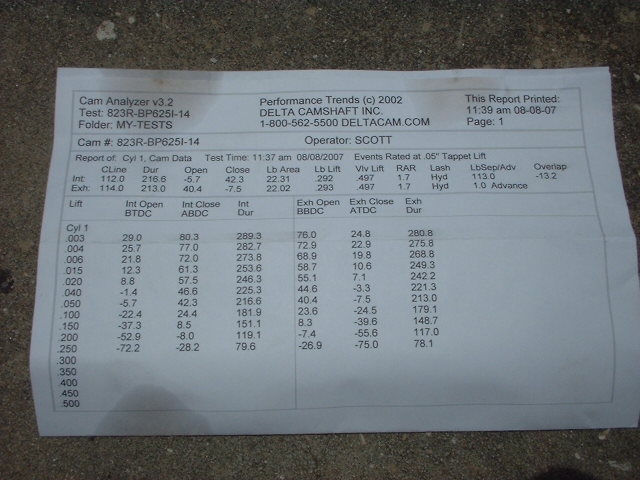

    I love the idle. What cam specs did you choose, and what RPM is idle?
    Can't wait to see it in action!
    EDIT: Watched the video again, and just before the baby blip, it looks like 550rpm?
    Yeah the idle drops from time to time and I believe in the video during the tale pipe shot it might have been as low as 400, the dual mass flywheel probably has a lot to do with that and I believe the Harley Davidson engines have a heavy flywheel that helps them keep chopping at very low idle. My idle is actually set at around 950 but tuning and possibly the IAC passage has an effect on it. The throttlebody adaptor plate from the store had to be modified because it has no passage for incoming IAC air so it's possible I may need to make the passage larger though I doubt it.
