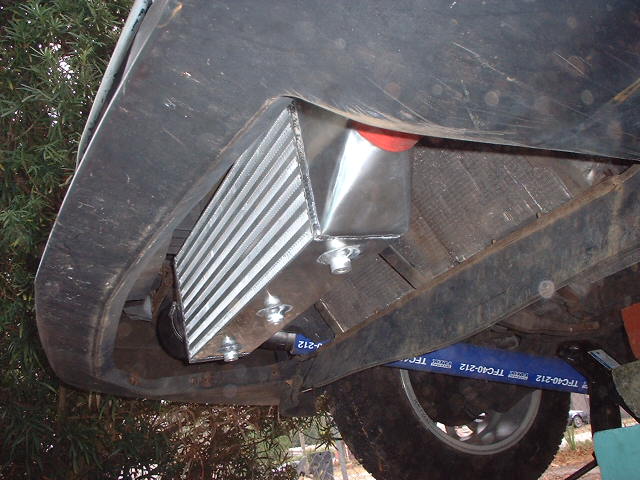

    Yes yes yes we all are waiting for some new video.... Getting closer. That intercooler made a HELL of a difference!!! Much better!!!
    Are the charge pipes going to the FMIC metal or some sort of rubber? having all metal pipes would add more to releasing the heat I would think.

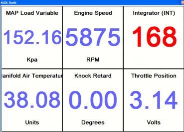

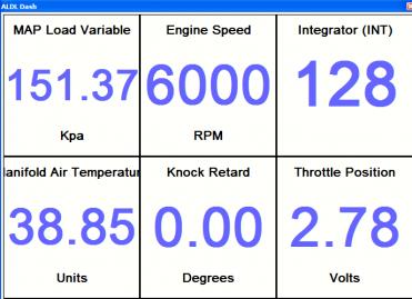

    Finally got around to testdriving but with no tuning to maximize performance. Verdict, down right impressive, the cam advance did excactly what I was expecting it to for the offline performance, it doesn't chirp the tires in first and second gear as easily as before partly because the tire pressure is low and traction is better, however it doesn't use the flywheel inertia the way it did before to cause that chirp, it pulls and sustains and although I didn't catch the first testdrive on tape to show it, it nearly got sideways once on acceleration.
    I've owned a TPI 350 Fiero and TPI 383 stroker Z28 and neither was this fast. The boost gauge is showing about about 9 psi but the MAP sensor is showing a max of 152 Kpa which is a tad over 7 psi which is about 1 psi below the wastegate spring pressure.
    I'll post video tomorrow since I'm about to hit the road headed back. I have an example of the VVT effect but the car is so fast with the cam advanced, that due to being reground to high performance specs I might not need the benefit of the VVT for higher output. I'm certain beyond a doubt that this engine is putting out over 300 hp given how hard it pulls throughout the rpm range.
    The front mount intercooler cut the intake air temps by more than half of previous temps on an 80 degree day as you will see in the screen shots below. Previously the intake temps as you can see above in a previous post were around 100 deg C or 212 deg F at 7 psi, during the test runs the inlet temps reached a maximum of about 42 deg C, 107 deg F, and that was idling in the driveway after the second testdrive. Note the 38 deg C at 7 psi. I'm not taking the car yet because it needs to be tuned. You can see the timing retard due to the lean condition. I expect it to be a little lean up top due to the cam position change and the higher efficiency shift to the right (lower rpm), I wasn't expecting it to be that lean though, good thing I used premium fuel to avoid a serious detonation event.

    I ran out of time again, the little odds and ends wore me out. I did get front mount intercooler circuit completed though. I'm not frustrated since several deficiencies were present that would have set me way back had I driven the car before finding them. While letting the engine idle for about an hour looking for problems, I found an oil leak and the next morning a massive water leak that resulted from a loose clamp and a loose oil sending unit.
