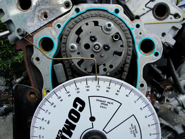

Very interesting Joseph. Thanks for taking the time to measure and post the numbers. The measurement taken on the CMM was 17.88 degrees max advance which is just over 2 degrees from the installed numbers. Perhaps the phaser wasn't at it's full limit when the CMM measurement was taken or there is some stack up error from the manufacturing process. That is the reason they make adjustable timing chain sets.

On a side note, the three M6 screws that attach the phaser to the cam seem a little on the small side. Hopefully they don't become an issue when people start putting big cams in these engines. Of course, I was never a fan of the single bolt setup on the earlier engines. The old three M8 bolt setup seemed quite reliable.

Guest repliedMaking progress towards getting the engine put back in the car. After addressing the camshaft I found that my 112 degree intake centerline was actually occuring at 92 degrees with the cam fully advanced so no doubt that's killing a good bit of power. I used my extra module to determine the thickness of the spacer I would need as seen on the engine, then I carefully removed the back side screws from the sprung module that would be used, carefully replacing them with drill bits to keep the forward hub that would normally be on the front of the module from releasing the recoil load which would be very difficult to restore if you let it unwind. I also placed about a .040" thick piece aluminum in front of the phaser to partially retard it from full advance to move it a little closer toward proper alignment for a little better baseline performance than what was present previously.
The stock cam would probably perform much better fully advanced than my reground cam. Interestingly two other 3900 swappers were not able to start their engines with the cam fully retarded. I could, however, their horsepower levels were about the same as mine if not a little more naturally aspirated and I'm running 7 psi, not sure what their torque levels were but that goes to show you how important camshaft position and grind is. My reground camshaft is probably more sensitive to position as a result.

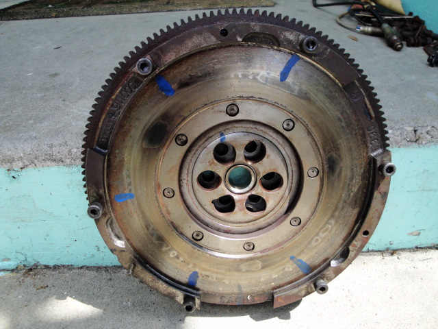

Guest repliedIf you exceed its capacity it will, that's by design. Some of the vettes with dualmass flywheels have this function also. Not all dual mass flywheels have this built in fuse.

I had to figure out a way to lock the dual mass flywheel and after giving it some thought I found myself at the machine shop. I had the pressure plate bolt holes chased all the way down through the base to stake the top half of the flywheel to the bottom. Some dual mass flywheels are torque limited and will slip, that's the reason for this modification. The top half is not tightened to the bottom, the screws just thread down into the bottom half but tighten against the pressure plate.
