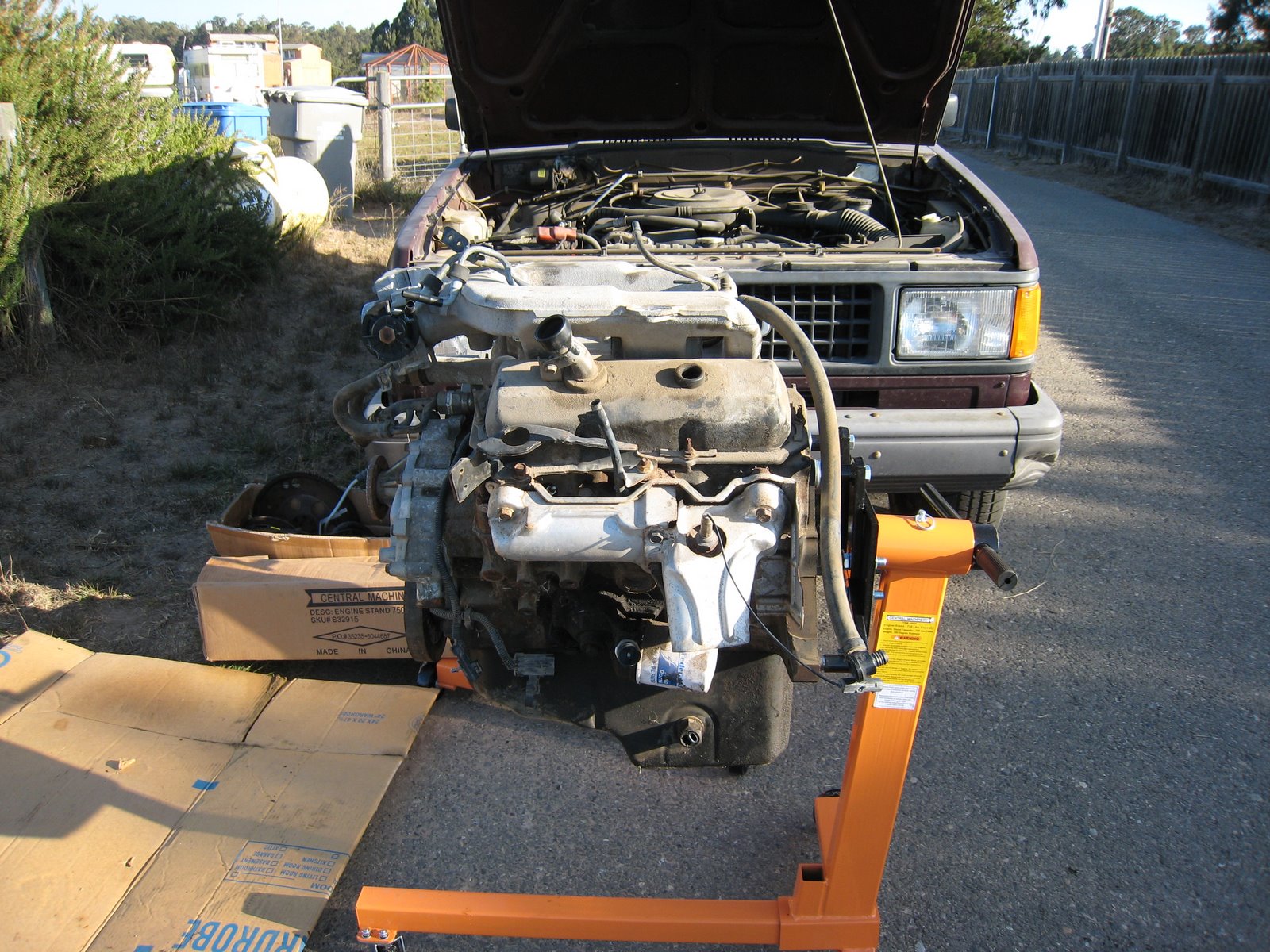

    The 4x4 pan is shallow in the front to clear the axle but has a very deep sump at the back of the engine. See the attachments (borrowed from another member's Trooper swap). Again, I must say that I don't know for sure that Jeeps are the same way. I just know that Troopers and 4x4 S-10s are.

    You will need to use the 4x4 oil pan. Best to get a new oil pump and pickup. The parts I used for the Trooper's oil pan were MEL-M134 (standard volume oil pump) and MEL-245S (4x4 pickup). I can't tell you for certain that the Jeeps used the same oil pan though. With the SFI swap, I kept the donor serpentine system, the Trooper system (which was also serpentine) wouldn't have cleared the intake. The downside was that the new alternator location interfered with my battery. So I needed to relocate the battery and saw away part of the battery tray. Again, I don't know if that is applicable to a Jeep.
    Does the 4x4 have different baffles set up? I am just wondering why it would need to be changed since the both hold the same amount of oil.
