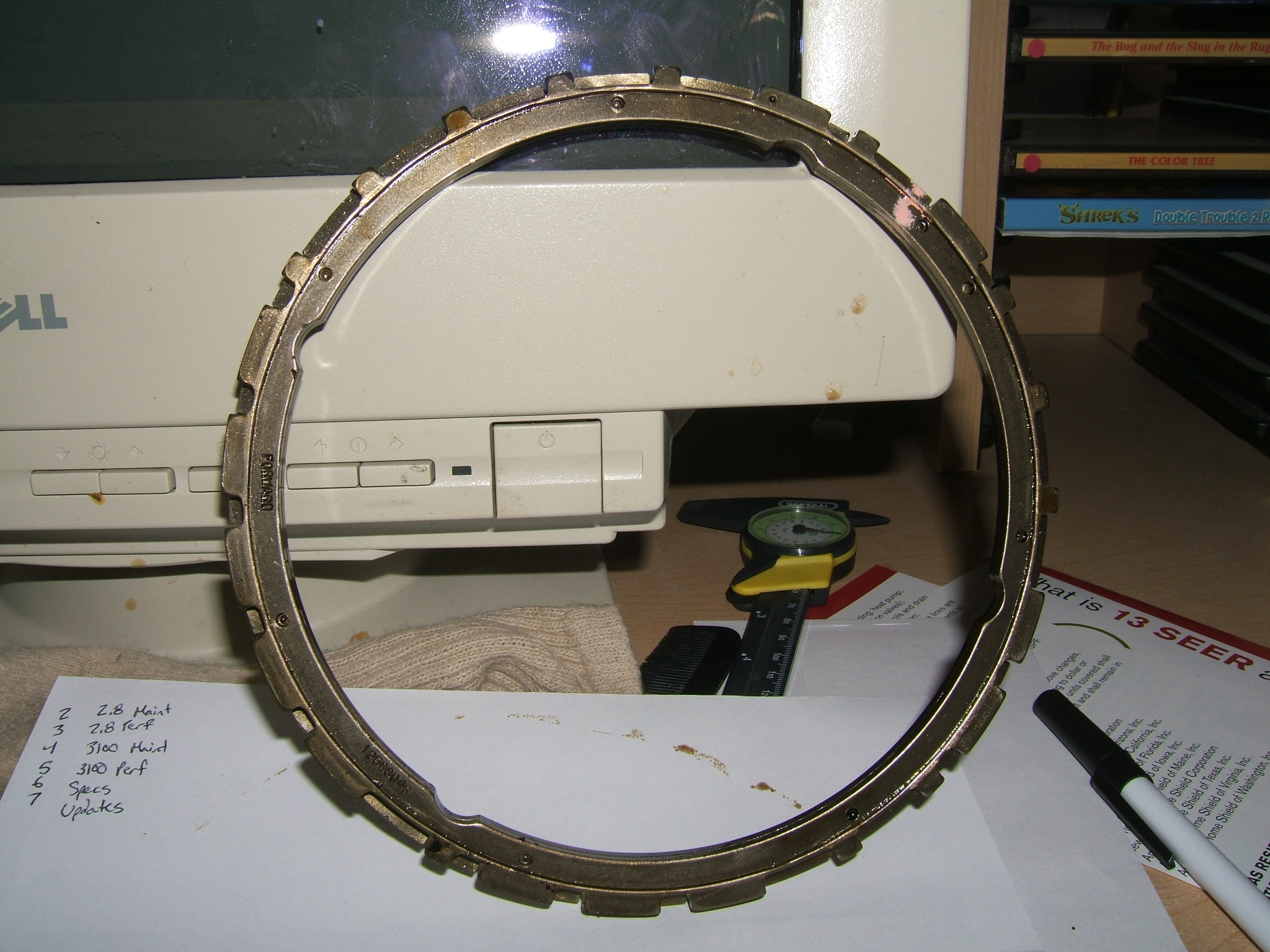

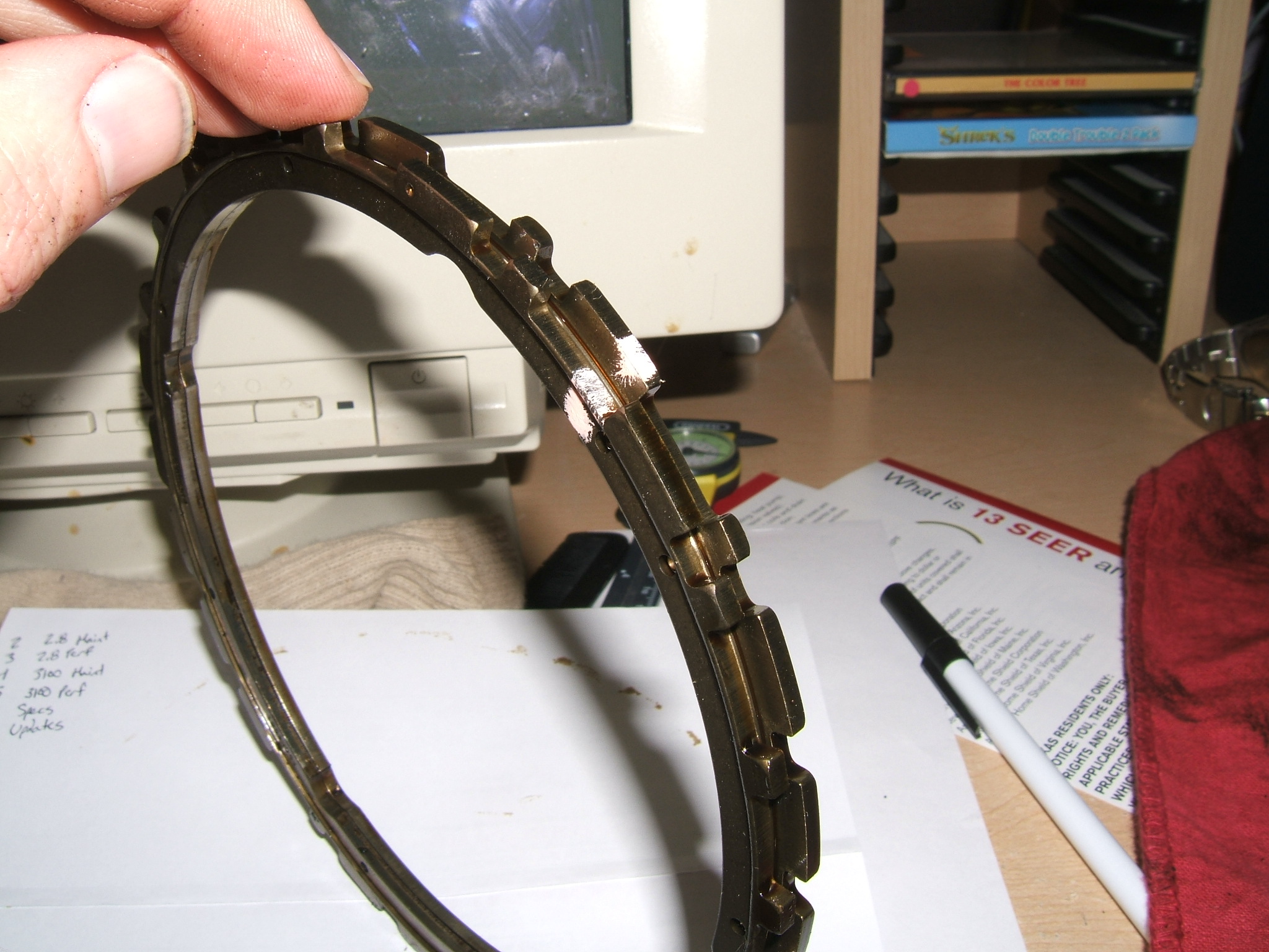

    Does anybody have a diagram of the lx9 trigger wheel? I have to figure out how to make megasquirt read the signal it's putting off. Does it have a notch every 6 degrees except for 2 to mark tdc or something like that?
    Trying to find a picture of it, but you won't be able to use it with MS. It is a coded trigger, so each cylinder is a different pattern. Ok, here it is...
ID:	374785Click image for larger version
    Here is a good thread discussing the trigger: http://60degreev6.com/forum/showthre...+crank+trigger

      jon, the 3400 ICMs(LA1 at least, i don't know if the last iteration of them used it or not) read the good old 7X reluctor that's been used in all of the 60V6 MPFI applications up until the 3500 came around and messed it all up.
      then it sends a 3X signal to the ECM, which determines engine speed, which is all it needs for batch-fired injectors and waste-spark.
