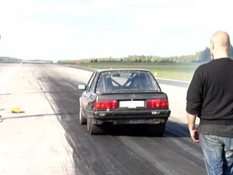

Here's what the 562whp/587wtq s52-powered e30 had to do to keep IRS and hook, yet still has only managed a 10.9...
