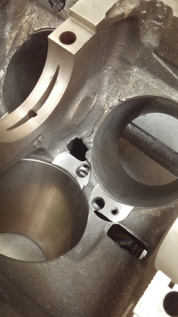

    But lets look a little closer at that front one:
    Damn, the position broke through the side of the oil galley, so mimicking the stock layout (which is also very similar to the LZ9 position) isn't going to work. The LZ9 looks to have more material in this location to avoid this happening. The squiters are offset from the centerline of the oil galley about .300"
    The machinist will do a couple more drill tests with a couple other positions that we discussed to see what will be best and clear the crank throws, etc. Any of the positions that would be used for the front oil squirter will need the tubes tweaked to get them pointed at the pistons.

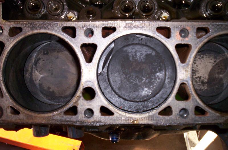

    I don't see any signs that detonation had caused this, there's no pitting or silver flakes that would indicate that was a problem.
    all my plugs were fine when I removed them, but I could actually hear the detonation happening even under part throttle. Had a bad tank of gas which ruined this motor.
    ringland busted off. Everything else looked just fine.
