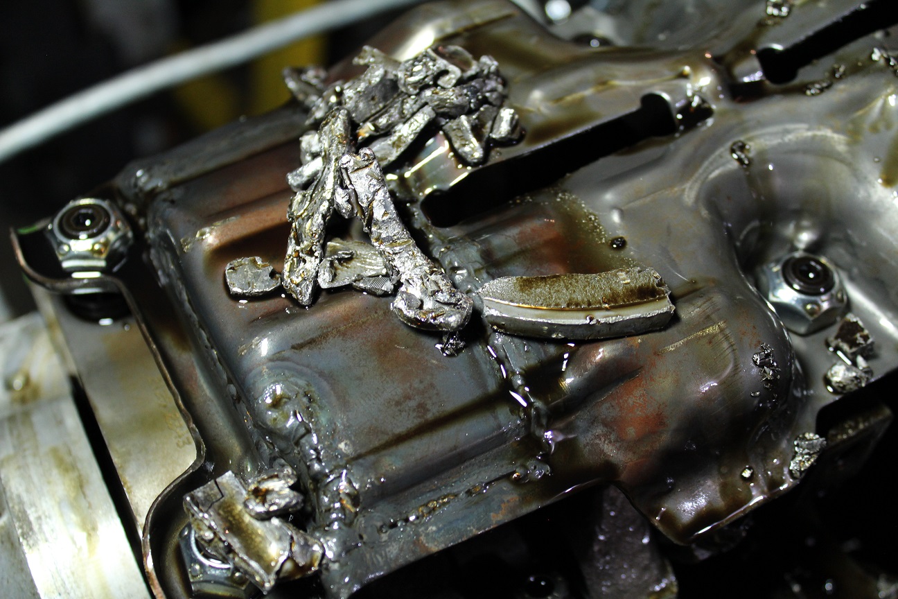

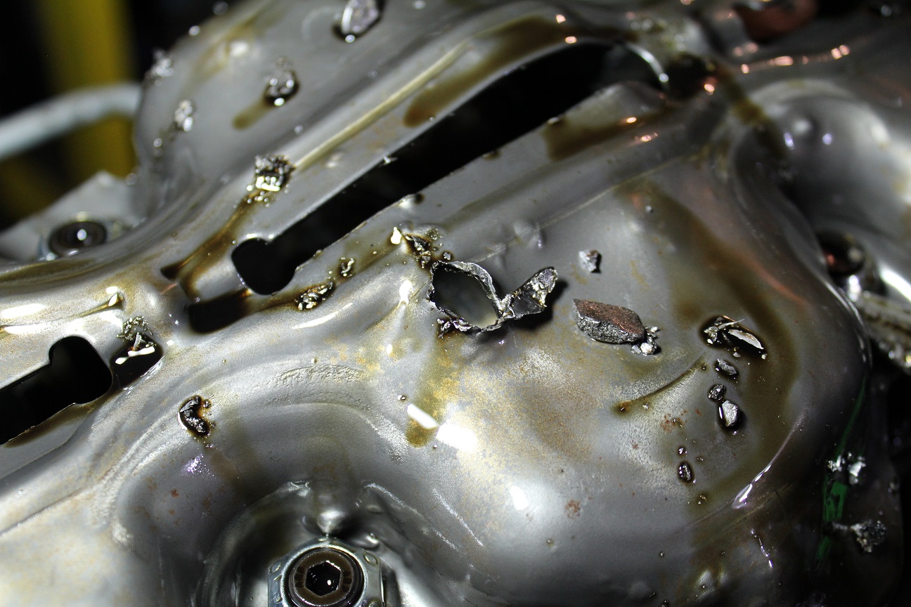

Guest repliedCarnage Pictures...
I found bits of the piston ring land in the lifter valley
You know it's bad, when you hear "tink", "clink", etc when you roll the engine over on the stand to pull the pan off. lol
That rounded piece is part of the piston ring land, found right where it is shown in the picture. Somehow top parts of the piston made it into the bottom end!

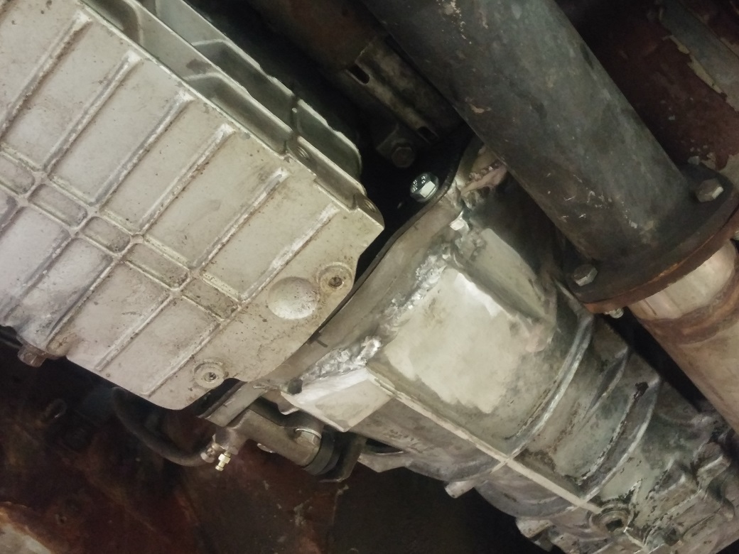

Some pictures of the trans and install:
Old trans on the floor in just under an hour.
I think the CFDF got a bit warm. lol
Spacer/shim for the new trans
Just checking the spine is correct before install
6 puck goodness
Yellow makes it go faster.
Just a few shots after the new trans is installed. It slid in better than any trans I have ever done. once I got the input spline lined up with the clutch disc it slid straight up to the block, no wiggling, no messing around, straight to the block. I wouldn't have believed it, if I hadn't witnessed it myself.
