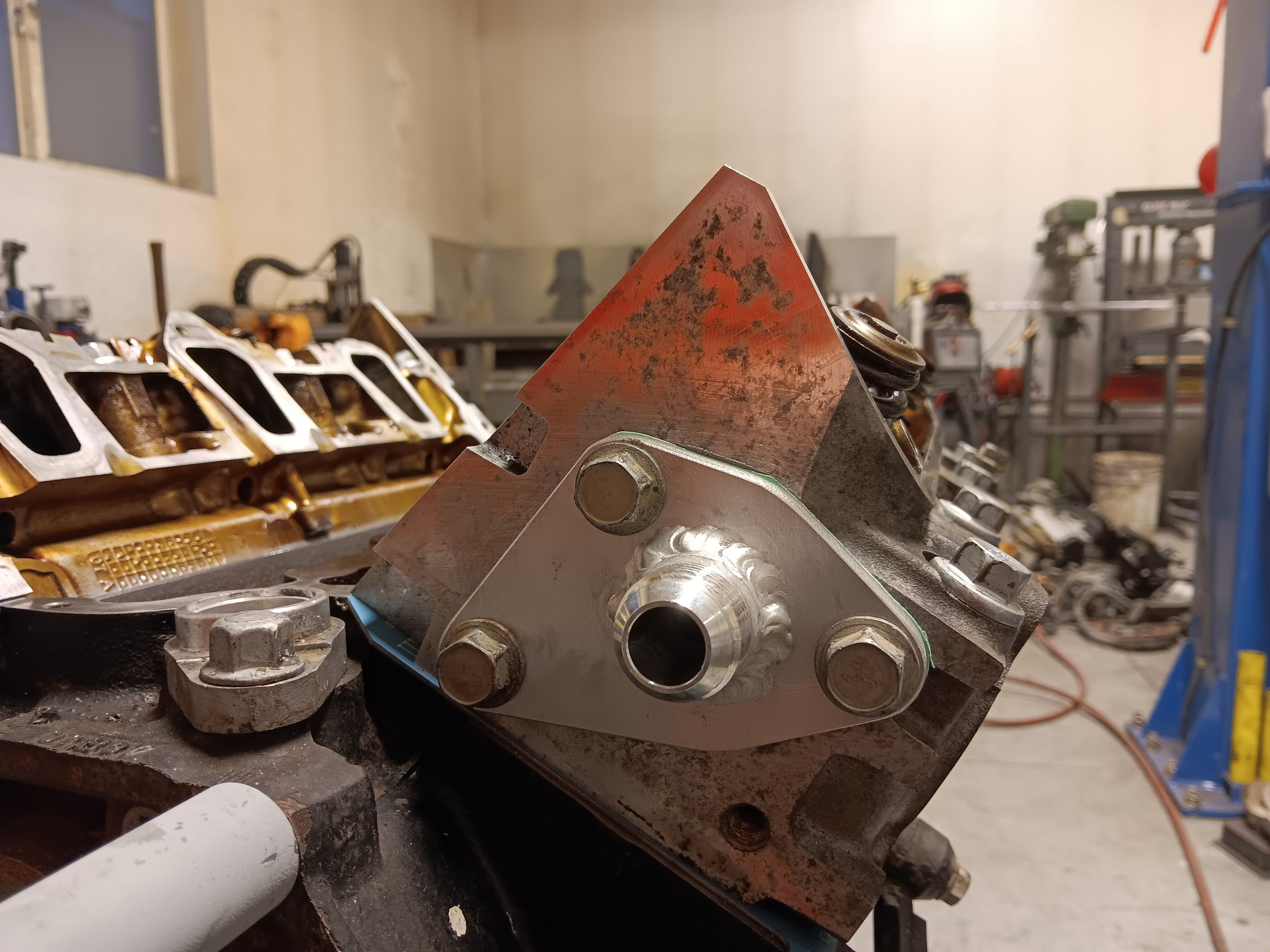

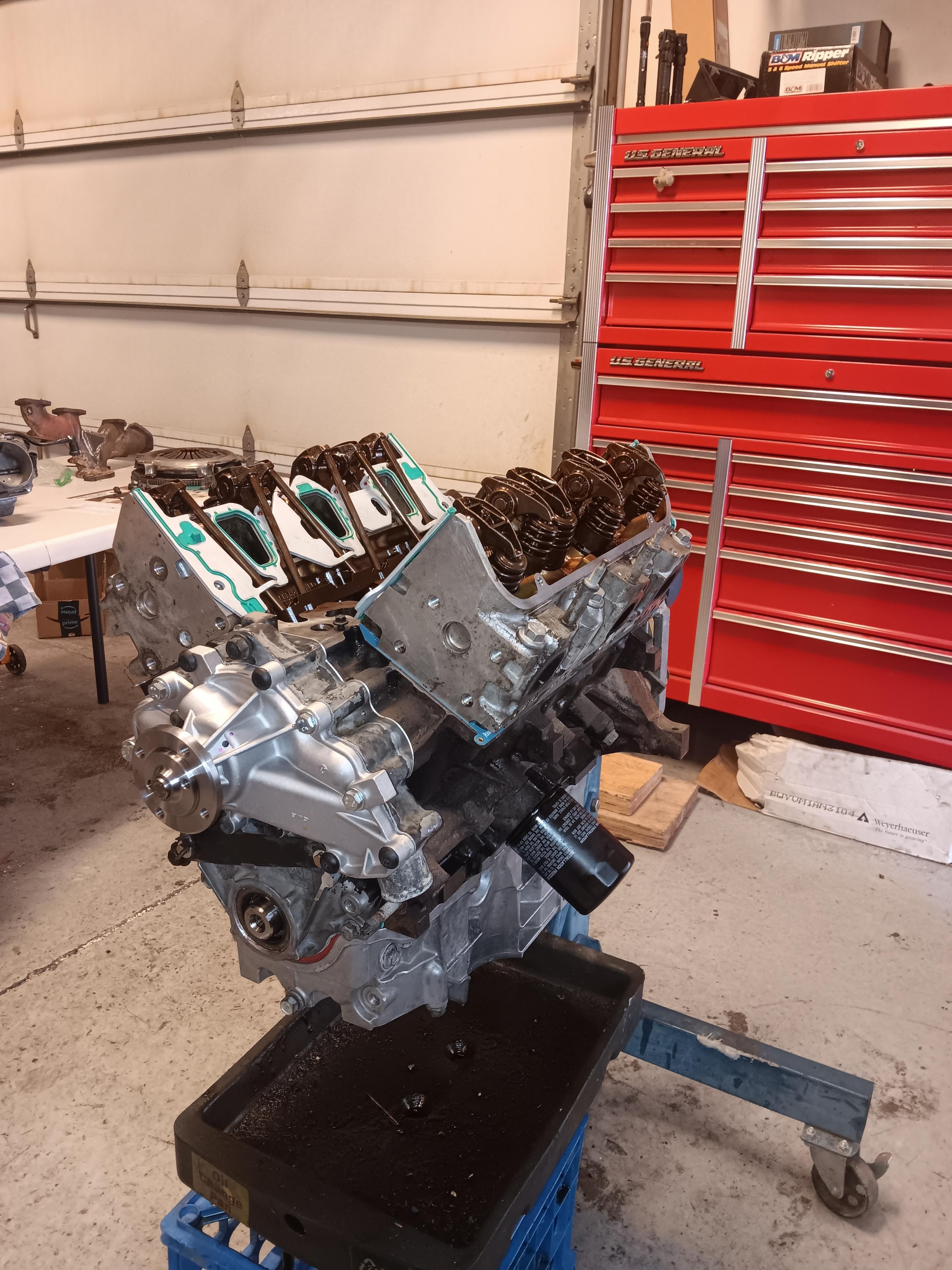

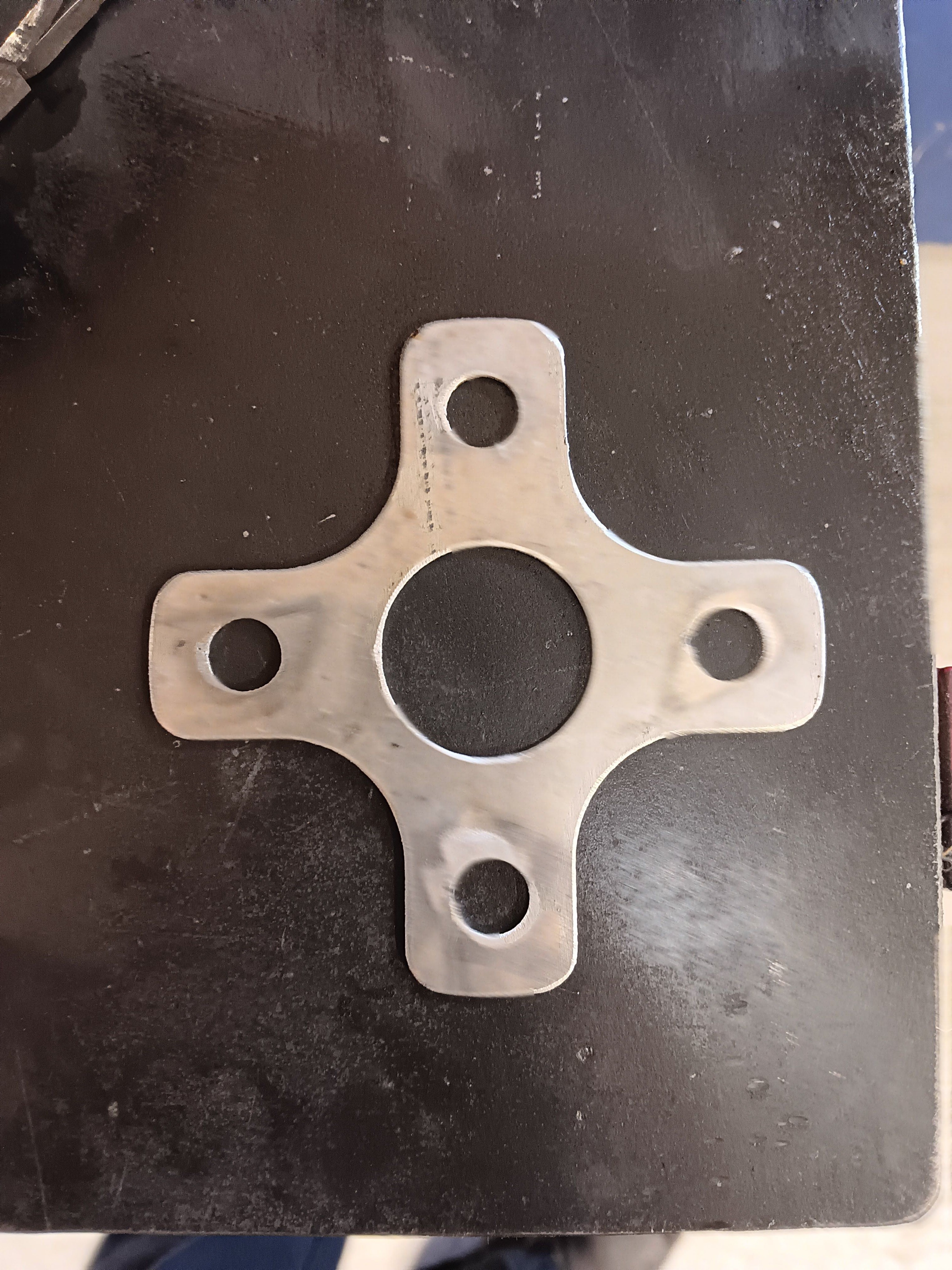

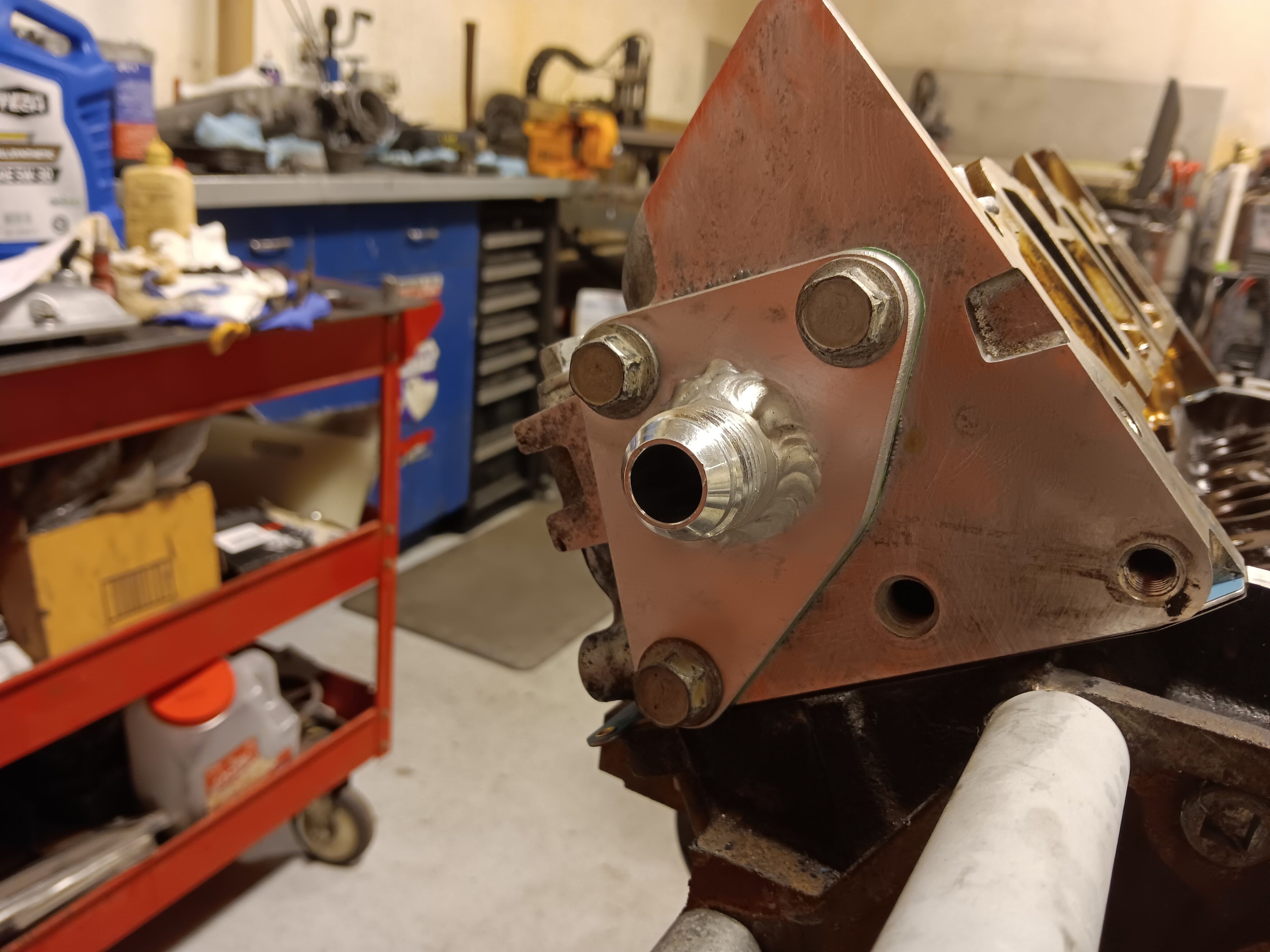

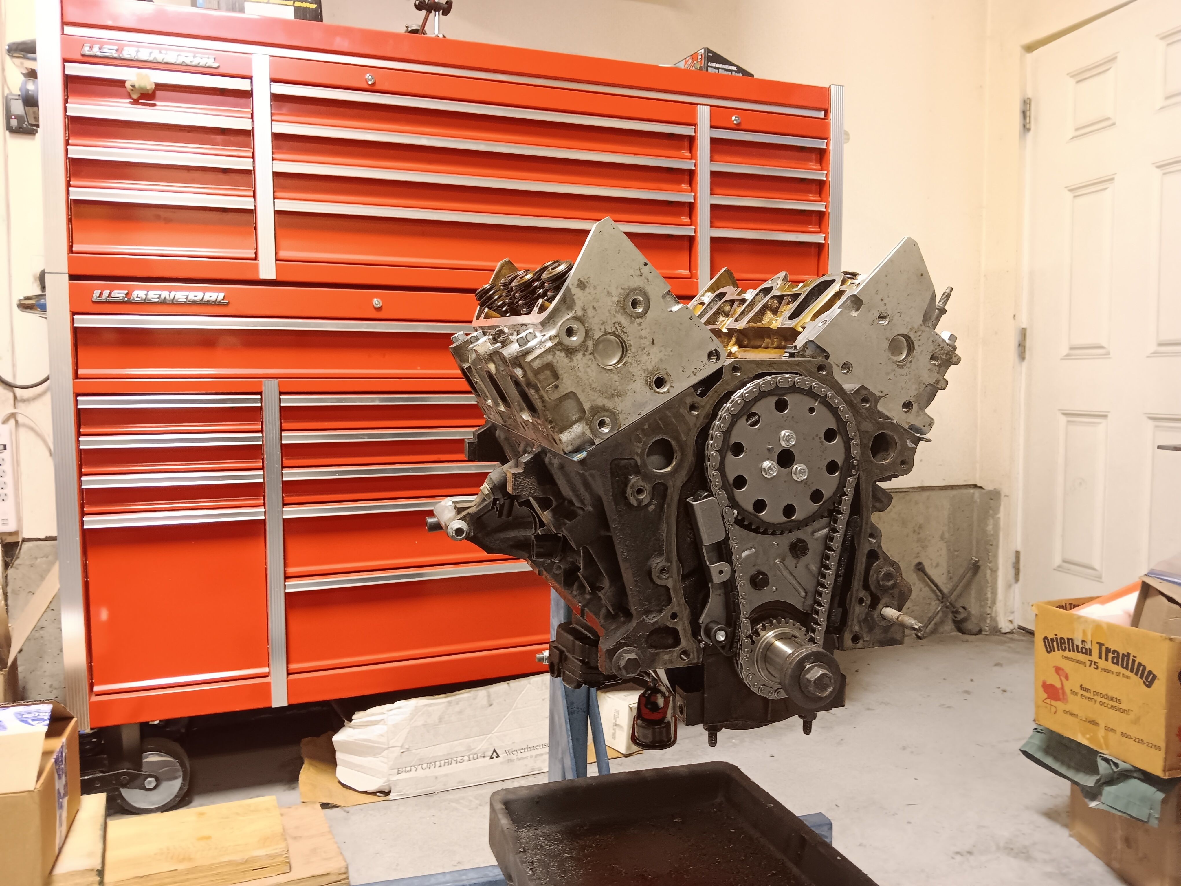

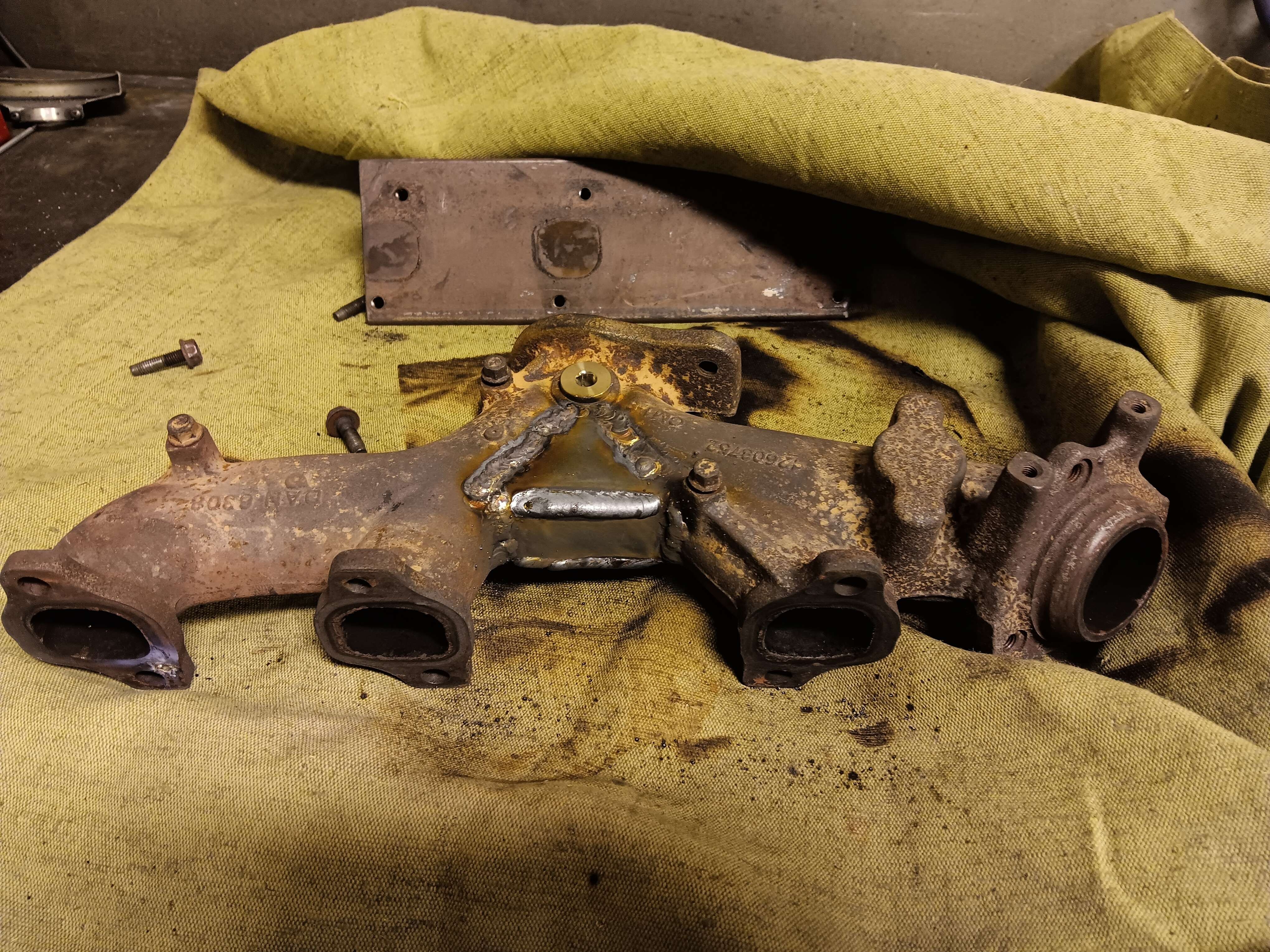

    I bought a 2007 chevy uplander about a month ago with the intentions to swap the LZ9 into my 1987 Fiero GT. I'm going to run it off of a MegaSquirt 3 pro mini. I am doing a VVT delete by using a 2007 equinox LNJ camshaft, and I'll use the old 2.8 timing cover. So far I have taken the LZ9 out of the Uplander and tore it down to the short block. I put the LNJ camshaft in and got the engine timed. I put the heads on, but flipped the sides from what they were as well as flip the head gaskets. I did this so that the coolant passages coming out of the heads are pointing the correct way. Some of the brackets I plan to use would also block the passages if I would have left them. I made some coolant port blocks for the heads that adapt them to a -12 AN fitting. For the exhaust I plan on using the majority of the factory one after the cat. I modified the right side manifold so that it might flow better and I will do a factory style Y pipe crossover. This will be my first engine swap so any tips or advice would be appreciated.Click image for larger version

      Nice, thats basically how the fwd race car setup is, with the heads swapped around and AN fittings out the side. It works Are you going to use SFI and LS coils? Personally, I can't imagine doing this swap and using a stock cam. Going boost later?

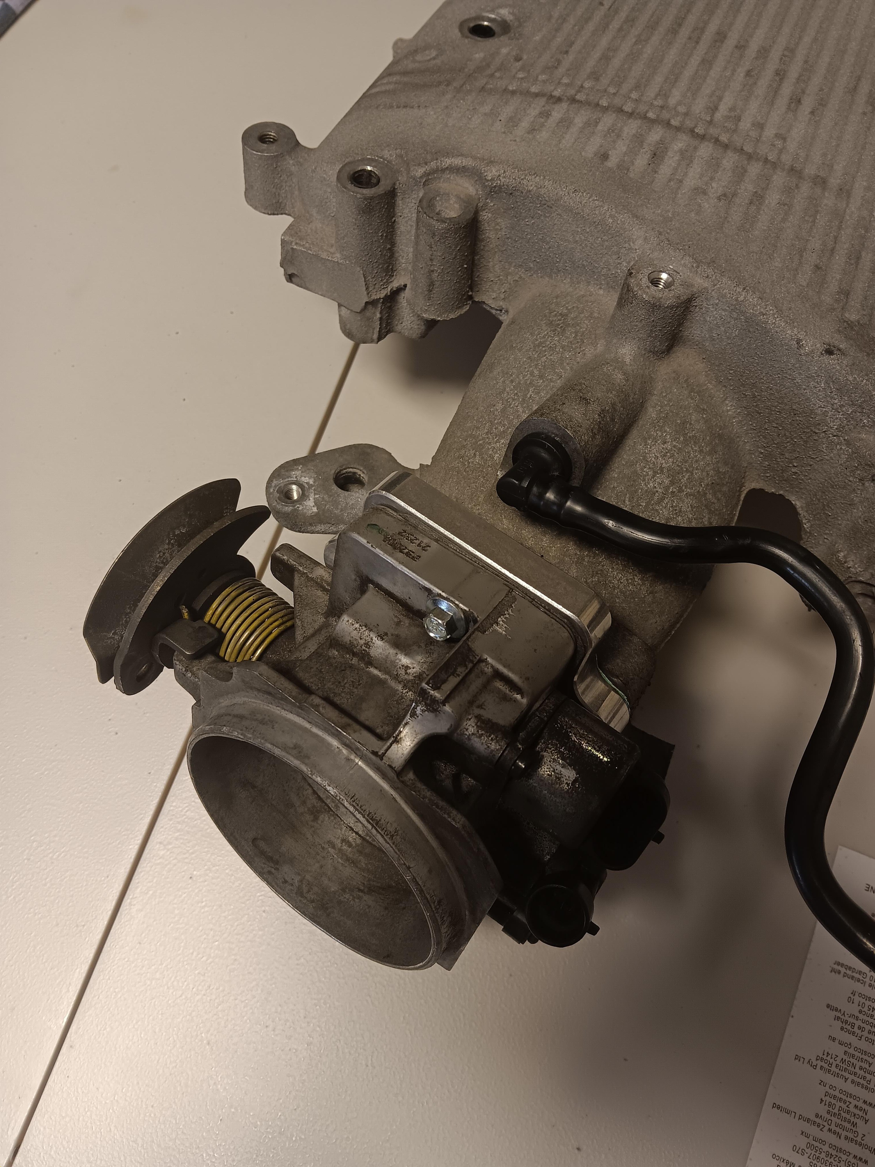

          I got the oil pan, valvetrain and Fiero timing cover and water pump put on today. Also showing what I did for the intake. I'm going to use a LZ4 intake manifold, and I bought a LS4 to 3 bolt throttle body adapter for it. The adapter didn't exactly line up so a few modifications to the bolt holes and inlet hole were needed for it to line up better. the throttle cam wasn't in the right spot so I twisted it around and welded it 90° from where it was.
Name:	LZ9 throttle body adapter.jpg

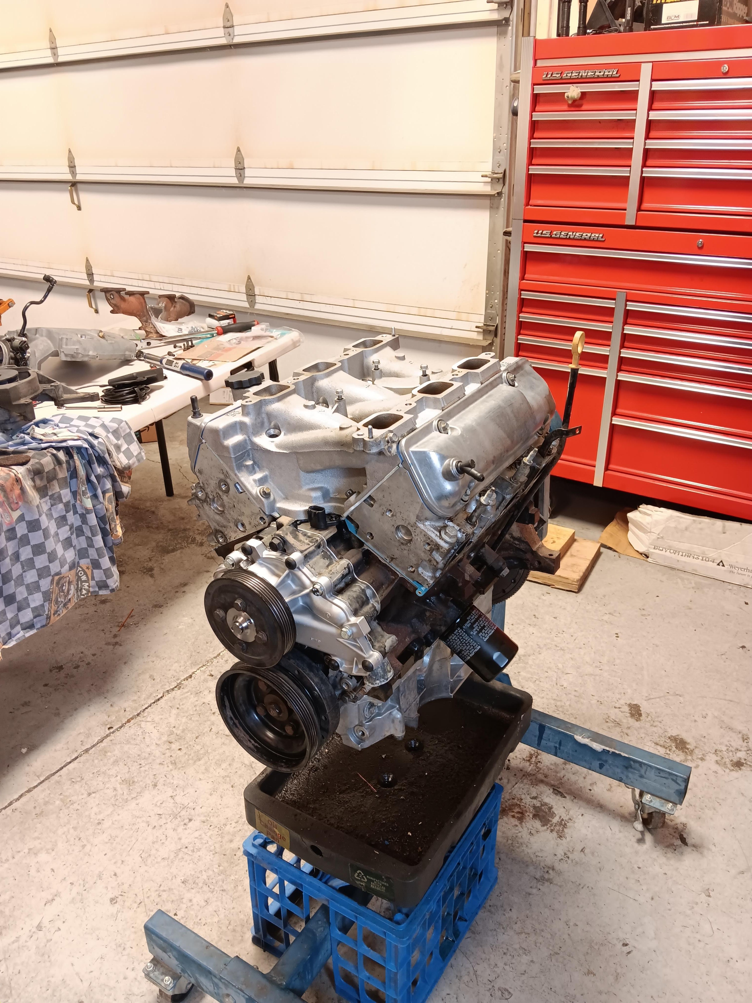

                  I got the LIM and valve covers on today. I also primed the oil system. There is a little 8mm hex on the end of the oil pump that you can drive through the distributer hole.
Name:	LZ9 with LIM.jpg
                  Here is the modification to the TB I mentioned earlier.
Name:	Throttle body modification.jpg

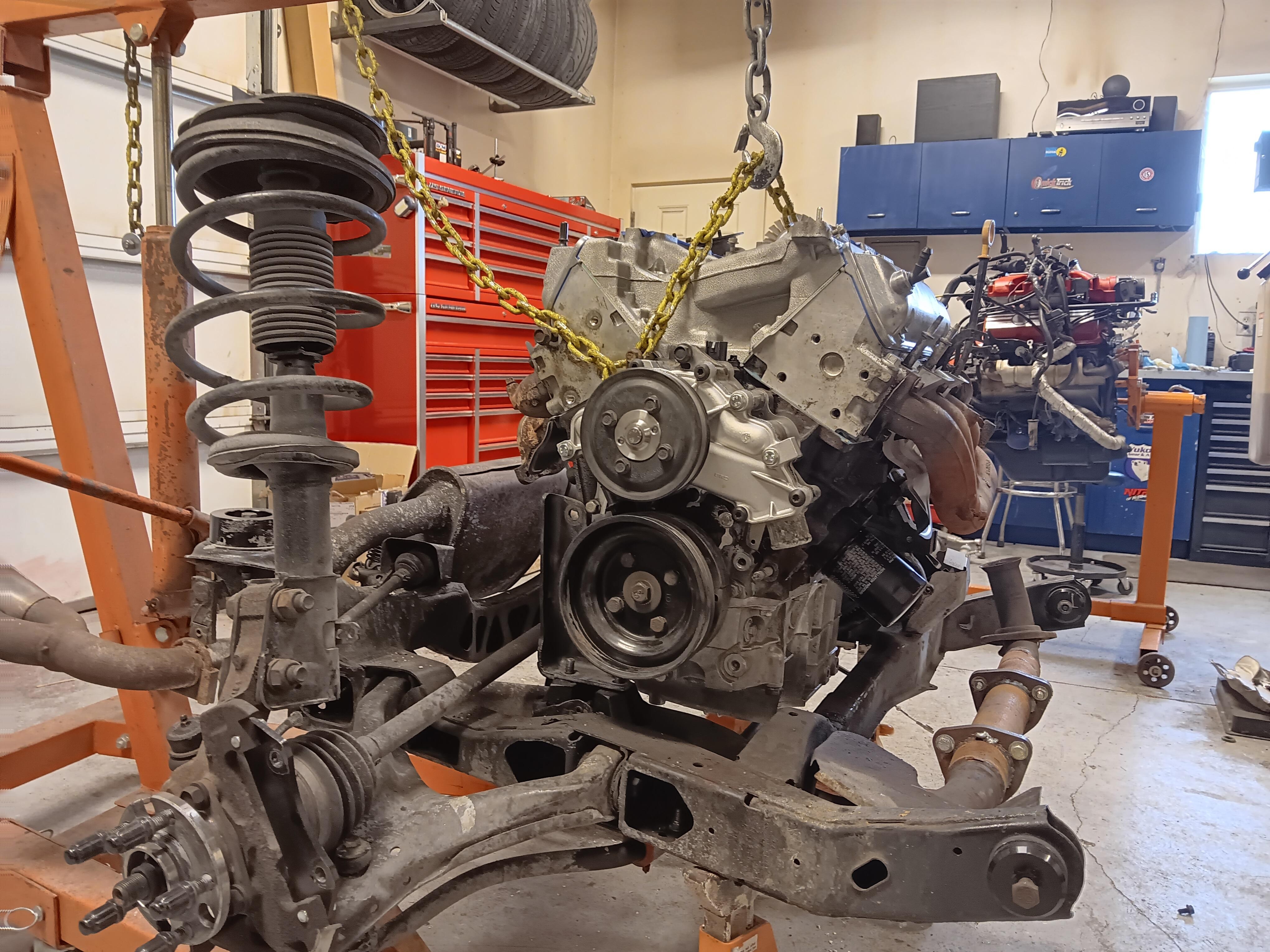

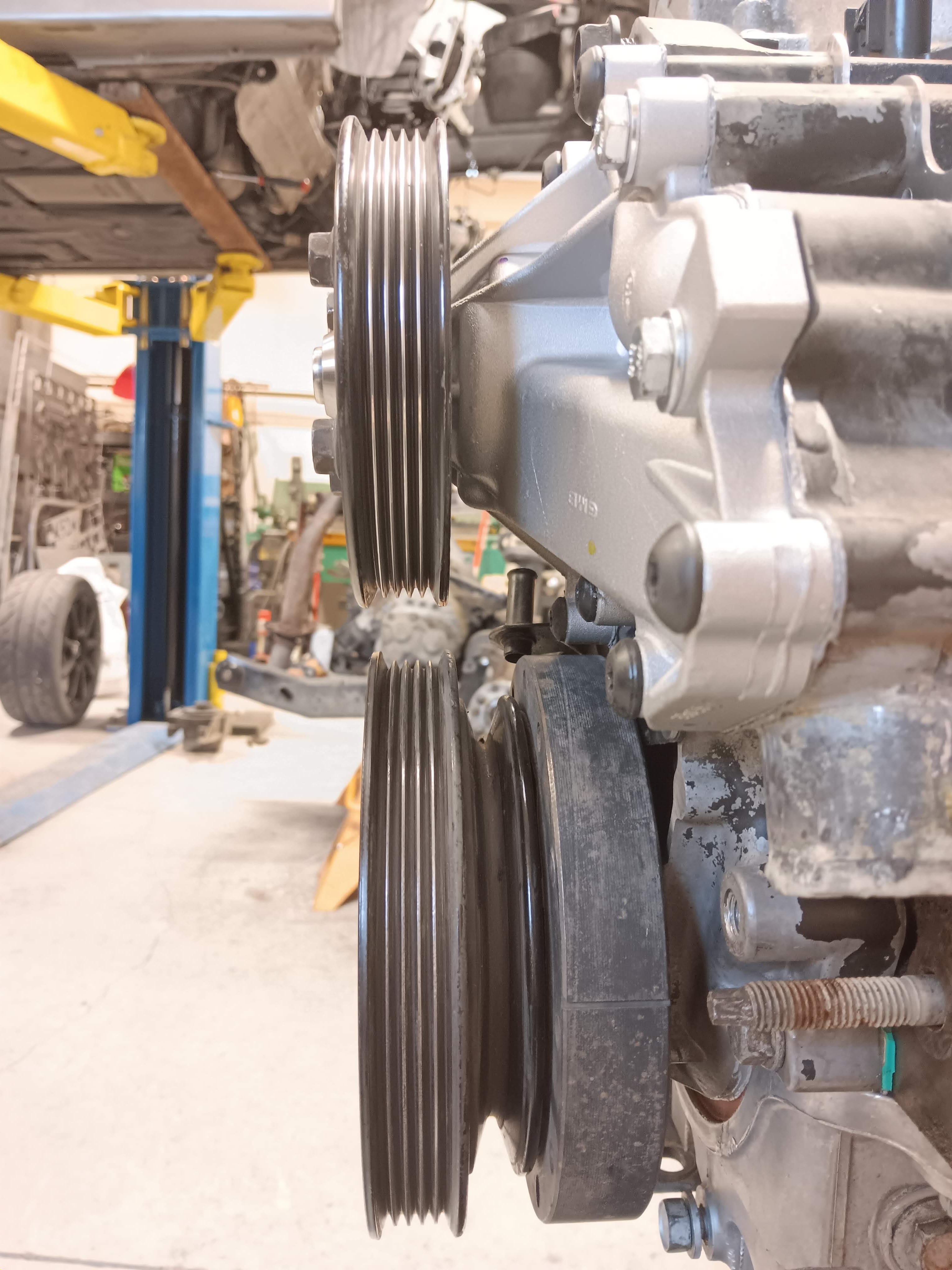

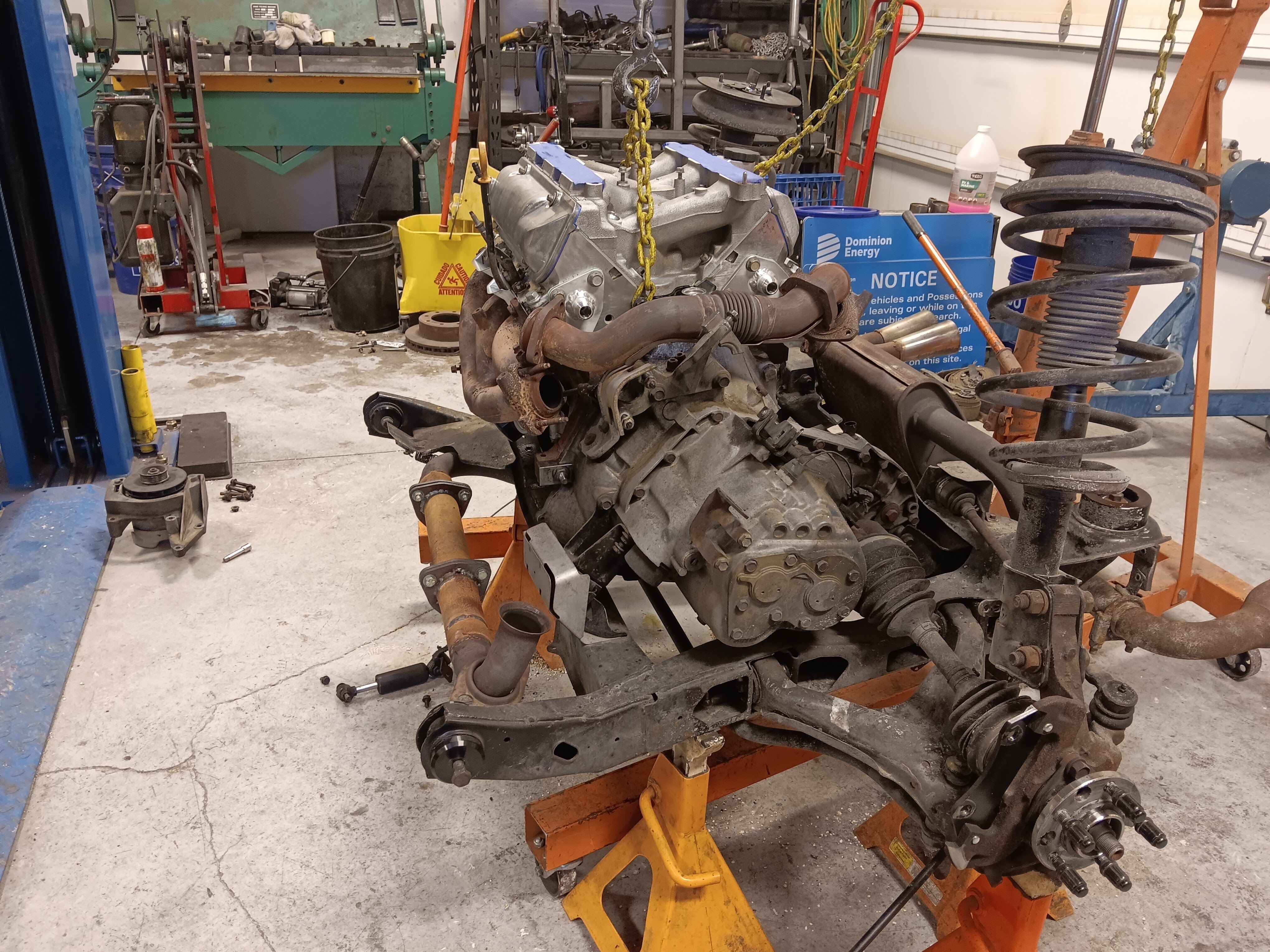

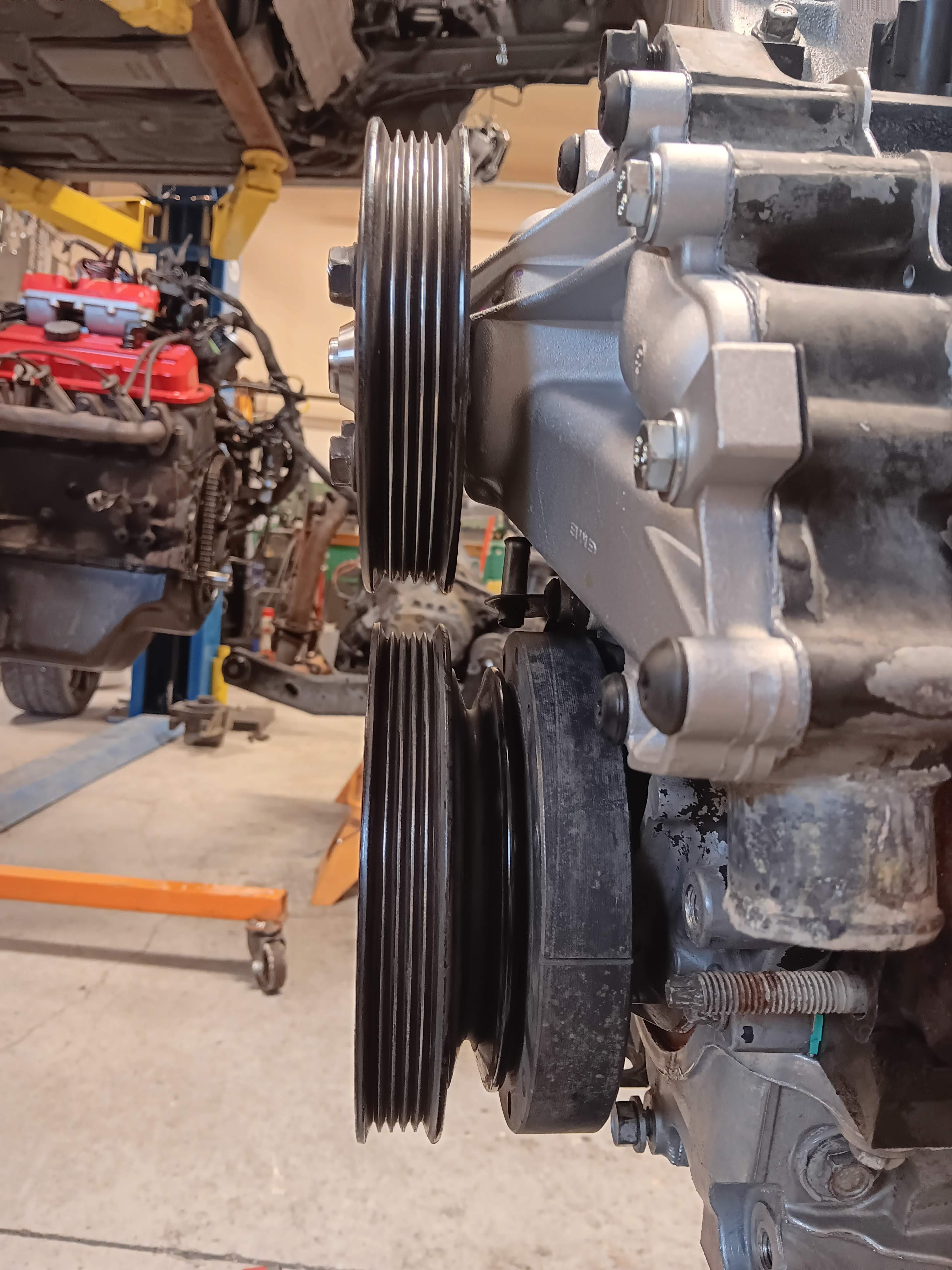

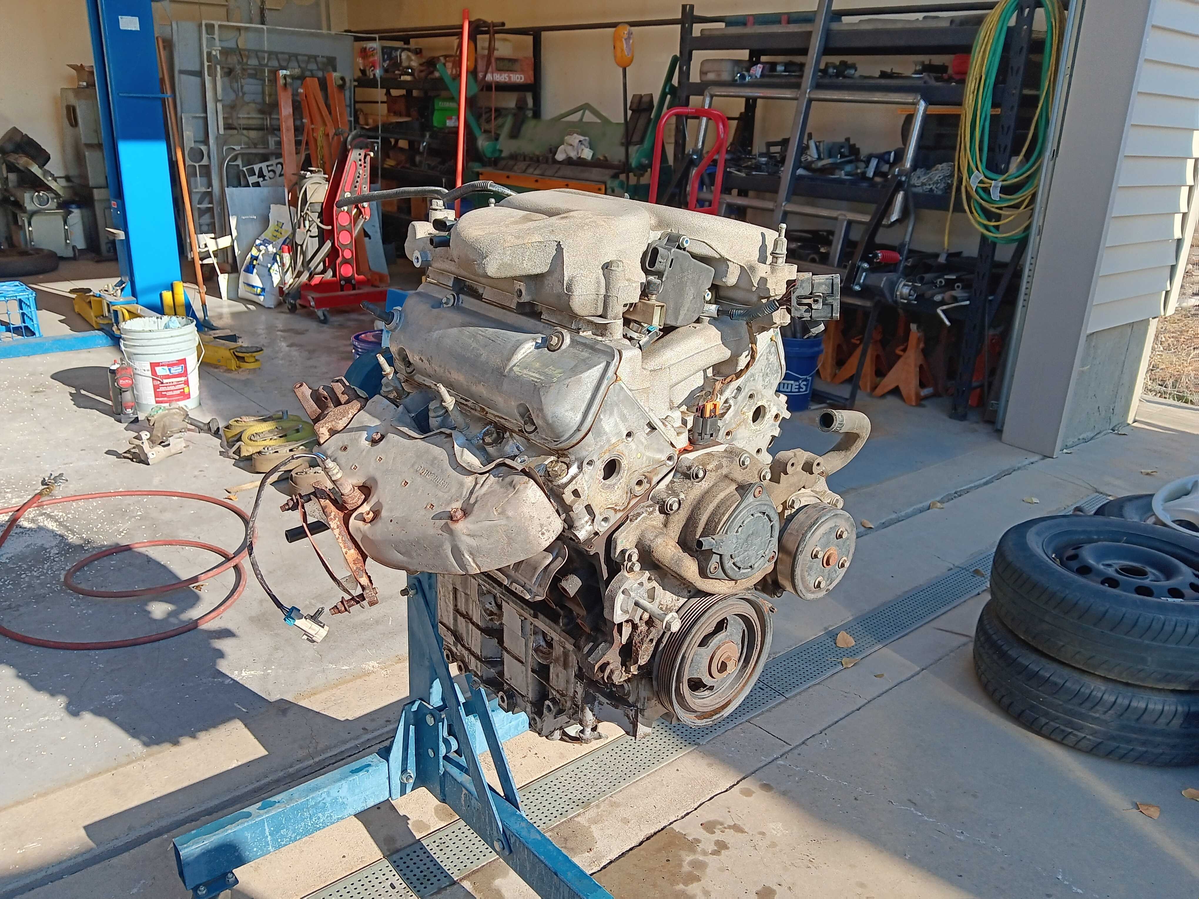

                        The other day I got the engine bolted to the trans and sort of sitting in the cradle. I need to make an engine mount for it still, the 2.8's mount almost fits, but it would have only one bolt to the engine. I plan on modifying it to connect to the oil pan and possibly another bolt on the side of the engine. I also caught the lz9 style timing cover gasket that I used had a slight problem with the Fiero timing cover. the gasket spaced out the cover and water pump enough that the pulleys didn't lune up anymore. So I made a spacer for the crank pully the same thickness as the gasket to line them up again.
                        Before
                        After

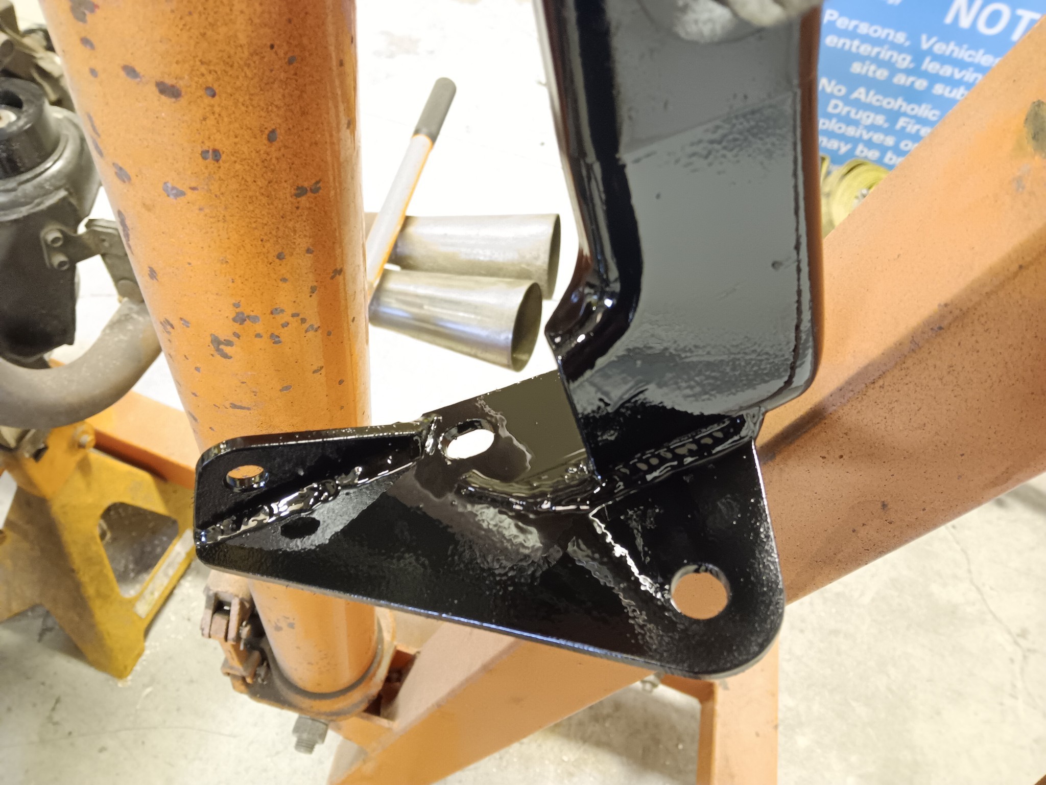

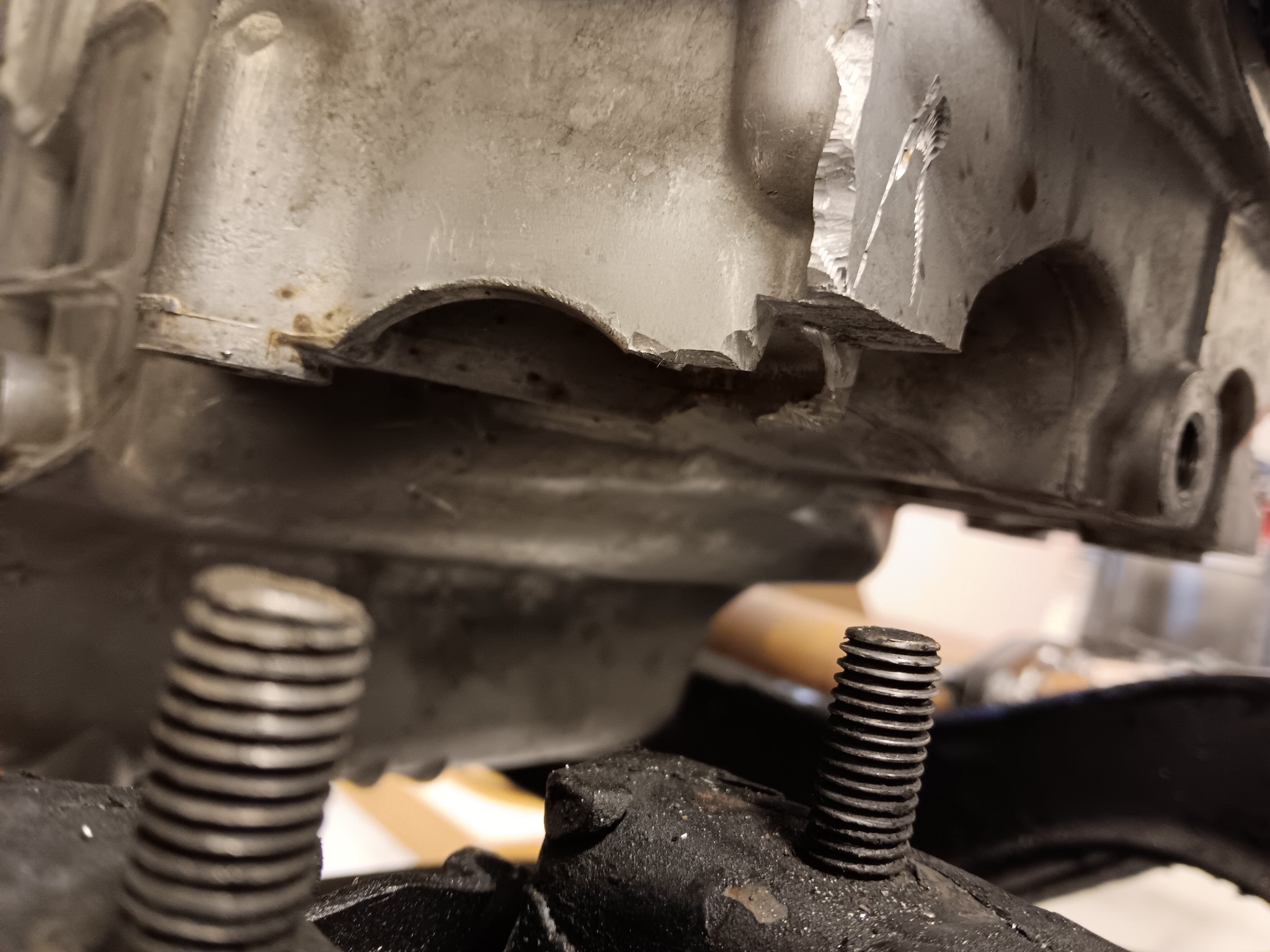

                          I got an engine mount that will hopefully work now. it's modified from the original 2.8 mount, and ties in to the oil pan as well as the one bolt that lined up to the block before. the oil pan had to be clearance so that the front stud on the engine mount didn't interfere.
