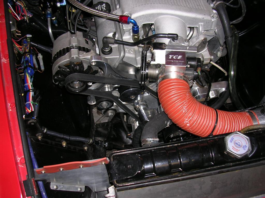

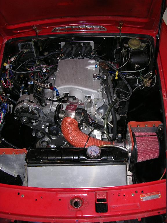

                      The pulse coder shown in Scotts link will work but will pulse around 8000/mile. Shouldn't be a problem though. I think Dann prefers using the Ford T5 due to it's higher 1st gear but it does require some mods to the bell housing.
                      The front cover does have an external trigger for use with the newer engines. You can barely see it in the pic below. I would like to find a cheap Midget for use to develop a V6 swap kit. Just have to add it to my list of things to do.
                      Saw the first completed 3500 MG using our components today. He did a very nice job on his CAI. The owner had a huge smile when he got back with it. He said it was FAST... no comparison to the Moss supercharged engine that came out of it. The real test will start tomorrow as he heads out to Vegas in it. I've got to get a ride in it when he gets back.
                      Heres a couple of pics of the install.

                        Did it clear the hood ok? What computer did he use? Looks like a lot of wires so that should be fun:P Was it stock otherwise? I will show my dad the pictures so he has an idea of what it will look like. Thanks!
                        • #27
                          He had to notch the hood cross brace a little to clear the EGR tube but it could have been moved to a different location. It's running a '7730 ECM and there are a lot of wires. I don't know if he plans to clean the wires up when he returns or not. The wiring was the only thing that I didn't care for. I believe that most everything else is stock.

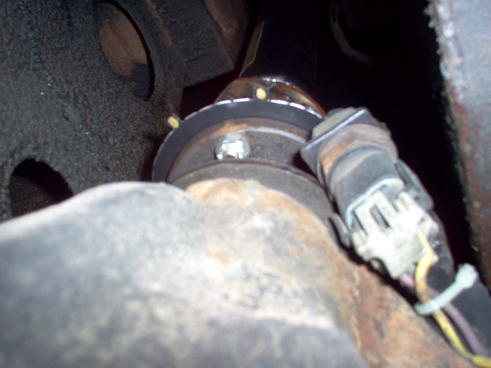

                                Sorry for not communicating this a little better. What I was trying to do was point out that there are other ways to approach this and you won't necessarily have to use a transmission driven GM VSS. You could drive your speedometer with the transmission and use the pulse generator referenced earlier to supply the ECM with a signal. I used an unconventional approach and made an 8 tooth reluctor ring and got a junkyard VSS from an early 90's 4x4 Chevy truck and mounted this to the differential (see pic). I calculated the pulses per mile and adjusted the RSSC with TunerPro. It's surprisingly accurate. You'll spend at least $300-500 for a decent set of gauges...maybe you've accounted for this in your budget but I'd rather spend that on something to help me go faster.
