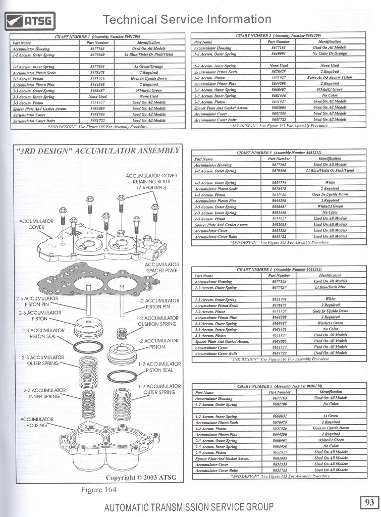

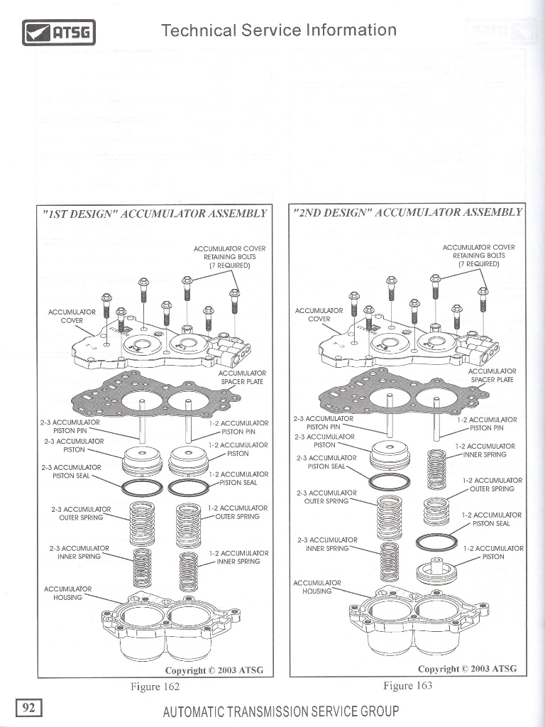

Ok now there is a HUGE list of springs that you can get... varrying from model to model of the 4t60e and what car it came in. Going by your pics I see you have a 94 3100 W-body, That gives you the 4AFW or 4CMW Now if you could verify that code that would be great, there is a tag on the back of your transmission by the diff cover, one of those 4 digit codes should be on it.
This means you do not have the same accumulator setup that I pictured. You have the second or third design, if your AFW its the second design, if its CMW you have the third design. Your 2-3 springs are the same as mine and setup the same way, your 1-2 however are TOTALLY different... I'm getting scans now of my ATSG book.
Attached are the three different types of accumulator pumps.... Now how to shim those last two I'm not sure on... Maybe someone with the same code trans has done it before and could chime in? Oh and .25 dia is too small... or is that inner dia?Last edited by 3400-95-Modified; 02-26-2008, 09:35 AM.
