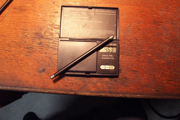

"The Milzy Motorsports Lightweight High-Performance Chrome-Moly Pushrods are made exclusively for us and your 3100/3400 engine!
These pushrods are made to the exact specifications of stock pushrods but are stronger and lighter. These pushrods are a great addition to your 3100/3400 engine with our custom cams or stocked cammed car. The weight savings these provide will decrease valvetrain weight and therefore decreasing valvetrain float and allow the engine to develop higher rpm's."

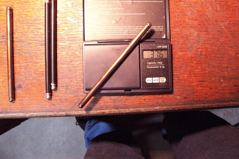

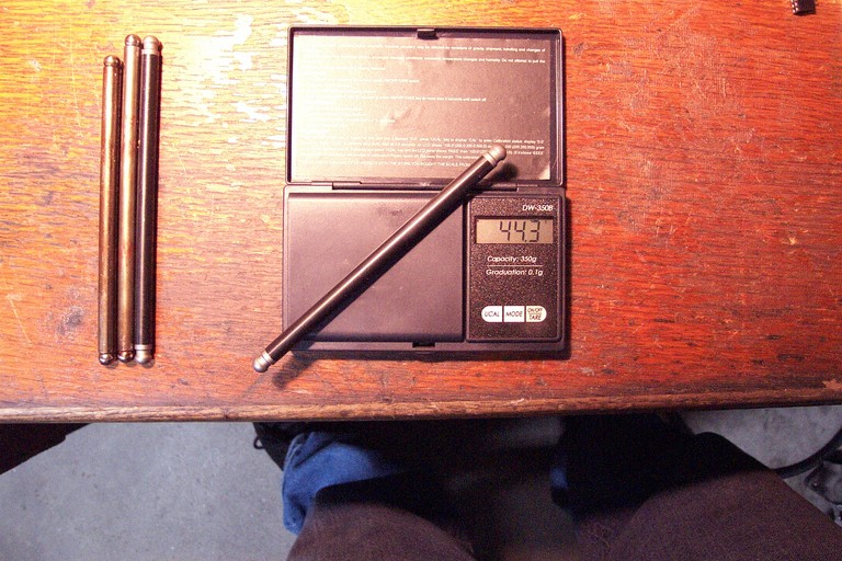

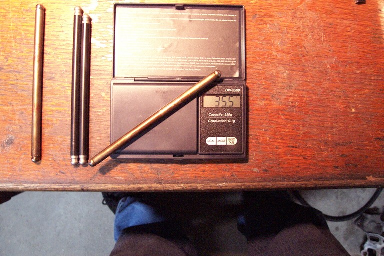

The gold looking pushrods are stock 3100/3400/3500 pushrods. The black and silver press on tip pushrods are the Milzy Motorsports pushrods.
makes you wonder about ppl. thx for making me laugh, it's been a long day at work...
