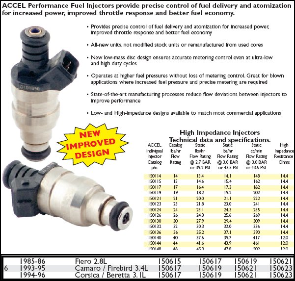

I am working on making a list of injectors... here is what I have to far... my concern is for the injectors used in W-body cars.
2.8 displacement:
VIN W - 1988-1989 2.8 MPFI V6 - 173cid
#17102747 {ACDELCO Part # 217267} {replaces 217-255}CODE 5235136
{DELPHI Part # FJ10001}
Max Flow: 15lbs(1.952gms/sec) OR 16.6lbs depending on source
Supply Pressure: 43.5PSI(300Kpa)
Multec1 TFP

I notice that the injectors in the aluminum headed 2.8mpfi and 3.1mpfi are the same injectors, and thus should have the same flow rate... but what is that rate really? and more injectors will be added to this list soon.
This is still wrong.Originally posted by Crazy K View PostVIN M - 1993-1998 3100 SFI V6 - 189cid
#17113572 {ACDELCO Part # 2171388}
Max Flow: 19lbs
Multec 1
94-99 is 17lb/hr for vin M 3.1
