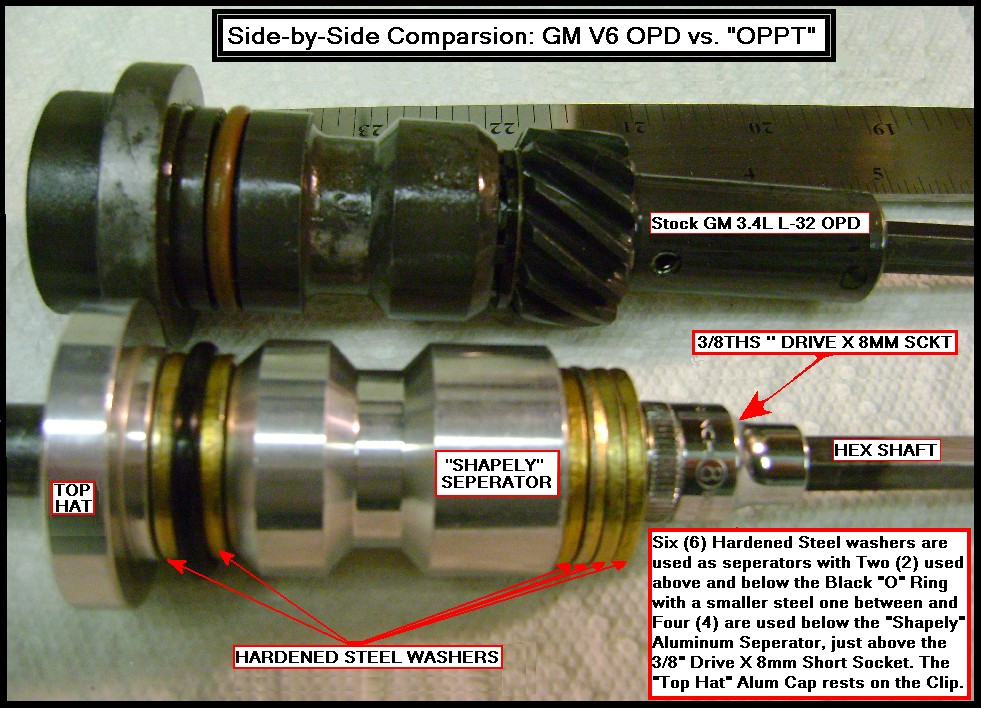

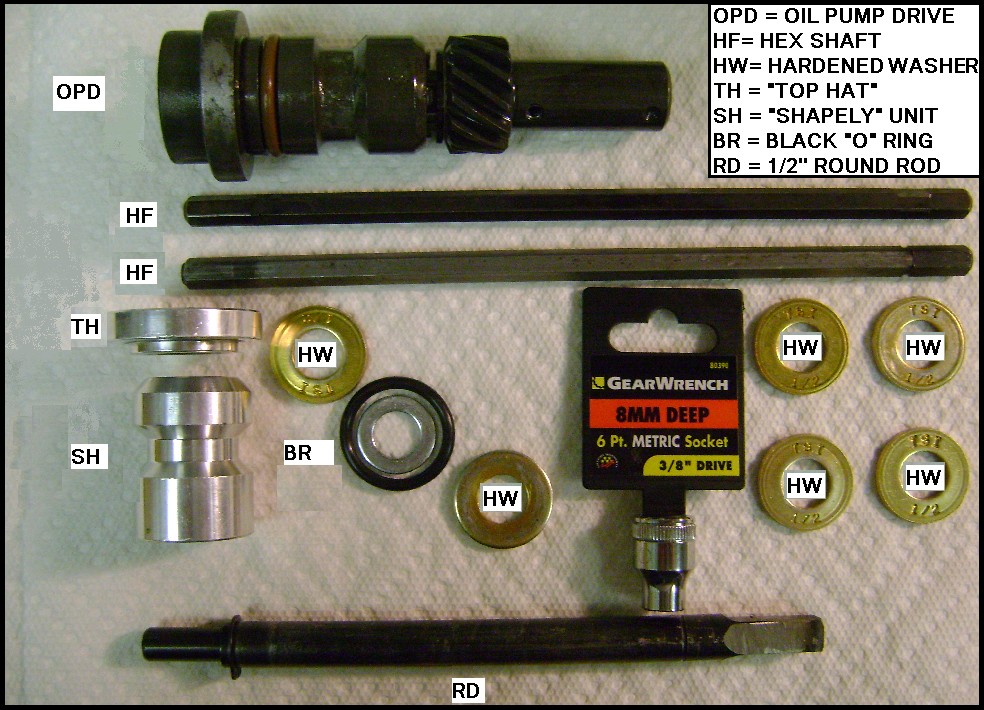

Building an Oil Pump Priming Tool for 60* Motors
Thanks for the inquiry but, not being a machinist or having access to 2.5" aluminum round stock, the hardened 8mm Hex Rod Stock and the metal lathes needed to shape it, it would be a daunting process to make them the way I had to do the first prototype "one off". But "patent infringement" risks aside, having done all the research on the parts and pieces while mixing and matching and grinding to get this one to work, I will be happy to soon share those dimensions and provide a "parts and pieces list". In advance of getting all these measurements, here is a baseline of the raw materials and procedures needed to make what the Auto Parts companies should have been making and selling years ago on our behalf: (OPPT = Oil Pressure Priming Tool)Originally posted by Firehawk94 View PostHopefully he'll drain the 19 quarts of oil before he starts turning the engine over
I like the priming tool that you made....any chance of you mass producing these things and selling them? You may be able to make a bit of profit if the price on the parts isn't too high to make it. In other words, I would be interested in one.
If you want the visual "CLIFF NOTES" to this Step-By-Step Instructional... Visist my Photo Bucket site HERE:
(1) You will need to buy some type of standard, available Oil Priming Tool made for the SBC/90* Engines, just to get at it for some of its components. The one you choose MUST be of the style that has that odd shaped aluminum barrel at the top that closely matches the design of the upper portion of stock GM V6 Oil Pump Drive for the 2.8L. 3.1L and 3.4L engines. It also must have a metal center rod that is at least 3/8" in dimensions to allow for the extra material to be ground down for a close fit into the squared off fitting on the end of the shaft. These SBC Pre-Oilers can run anywhere from $30-$45 from RockAuto, Northern Auto Parts or Summit online parts catalogs.
(2) You will need an assortment of Hardened Steel Washers to use as segment separators and serve as thrust bearing surfaces along the length of the stock 3/8" steel shaft to align the parts in such a way that the PTFE or Black "O" Ring needed to seal the upper rear engine block from leaking can be aligned perfectly in the upper groove of the engine block, while the drill is working away on the 3/8" steel shaft in the center to build up oil pressure. Adding and subtracting washers helped find the right spot for the "O" Ring. These shafts come with various grooves machined in along the length of them with locking, high carbon spring steel rings that will all have to first be removed before installing the washers as space and distance adjusters.
(3) A decent bench grinder, along with a spray can of WD-40 to oil quench the 3/8" steel shaft every so often when it gets too hot from all that grinding needed to take the round 3/8" steel shaft down to the snug size of 3/8" SQUARE MALE END needed to plug the now shortened AND SQUARED OFF 3/8" Round Shaft into the base of an 8mm Socket. The 8mm Oil Pump Hex Rod then fits inside this socket when the Oil Pump Priming Tool is guided into the engine block Oil Pump Drive opening. This is where all of the real labor comes in by trial and error to get the length of the round 3/8" rod ground down and squared off...just right.

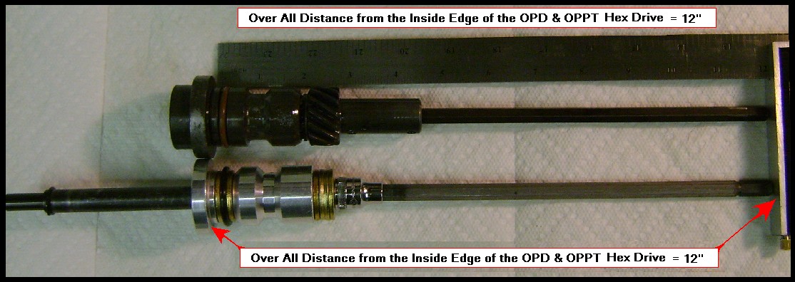

(4) Having an extra, stock GM 8mm Hex Shaft would help by allowing the builder to compare the new tool's over all length and the position of the machined aluminum barrel at the top for "O" ring alignment purposes when shown alongside the stock GM Oil Pump Drive with the 8mm Hex Shaft inserted all the way into the unit. When the intermediate parts of this thing are assembled, the 8mm Hex Shaft has to be a perfect match in length when pushed inside of the tool socket in order for it not to be too long or too short and risk having it coming out of the top of the oil pump female Hex receptacle and then dropping down inside the engine during the hectic oil pump priming process. all the "In Between" parts of this tool must not come loose and fall inside the motor. I was tempted to glomm some JB_Weld all over the tool around the shaft/socket interface, but in the end, I think TIG welding the 8mm Socket to the shaft will provide more security and stop the socket from popping off after having the 8mm Hex Rod rattling it from the inside. Having this arrangement allows for the Nylon Locking clip to be installed over the female Hex End in the Oil Pump along with a new, stock 8mm Hex Shaft when the pump is finally installed, bolted down and torqued to spec. One last consideration is making certain that the socket being chosen is NOT larger in diameter than the Hypoid gear on the stock Oil Pump Drive! (We don't want to damage the matching gears on the in-dwelling camshaft...)
The only thing the user of this new OPPT has to do is afterward, make certain that the Hex Shaft poking upwards from inside the engine block makes its way up inside the OPPT before full insertion and bolt down with the Oil Pump Drive Clamp at the very back of the engine.

New and final design for the oil pump priming tool
All New and Updated Photos/Parts images can be found here:Originally posted by Firehawk94 View PostI like the priming tool that you made....any chance of you mass producing these things and selling them? You may be able to make a bit of profit if the price on the parts isn't too high to make it. In other words, I would be interested in one.
Okay... After re-configuring and simplifying the design and building the best model of the Oil Pump Priming Tool that I can create, I have completed the writing of a "HowTo" article on this matter and created a Photo-Display that shows the new potential builders of this "OPPT" as I have taken to calling it how it can be done and submitted everything to Brad bszopi, along with all the necessary, precise steps and materials required for the making of it ...and what it should look like when completed, for his editorial approval and posting on the main page. All measurements and product sub-parts and procedures are covered as completely as I thought possible. Please disregard any of my prior posts, instructions or images, as the newly designed one looks and functions quite differently from the prior design I offered. I am including three (3) of the four (4) images I sent along to Brad as an attachment to this post so that any other images already offered by me can be deleted in exchange for these. I hope the design for this device proves useful to all concerned.
