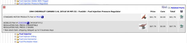

No need to be hyperbolic.... Why would I lie about a thing like that? See for yourself... (See Attached Image...)Originally posted by asylummotorsports View Post^^WHAT??^^
Rock Auto. www.rockauto.com
New AC Delco regulators for under $65.
Aftermarket units as low as $40.
Takes 20 minutes to swap out.
That one (listed for the 3.4 Camaro - not sure why the pic is so small) is only $67 from Rock Auto.-Brad-
