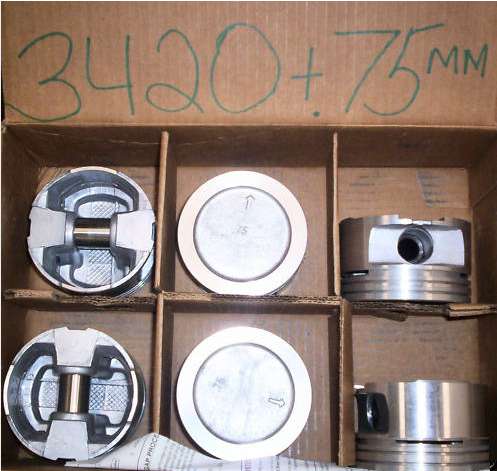

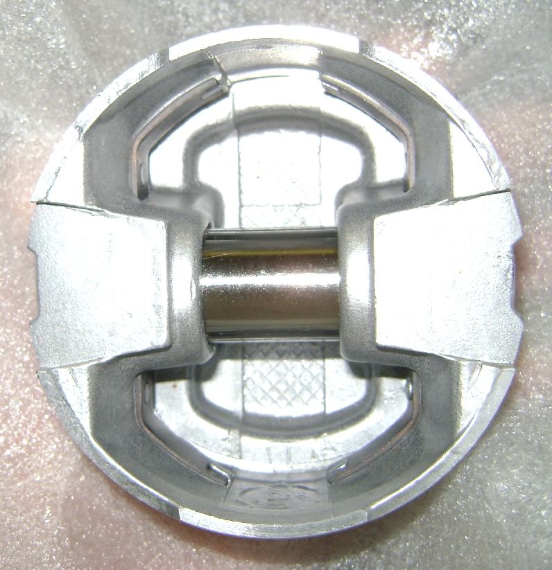

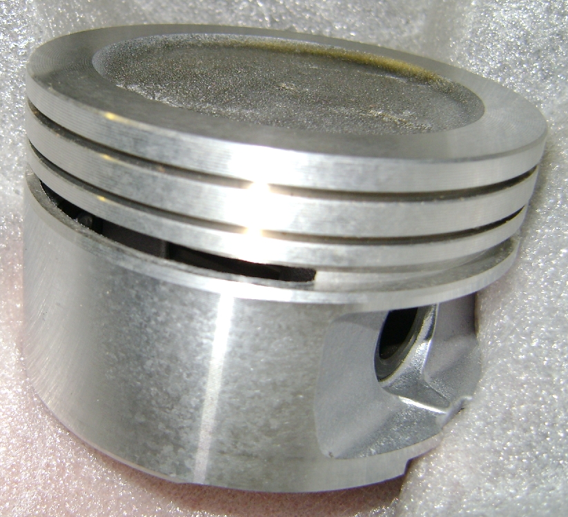

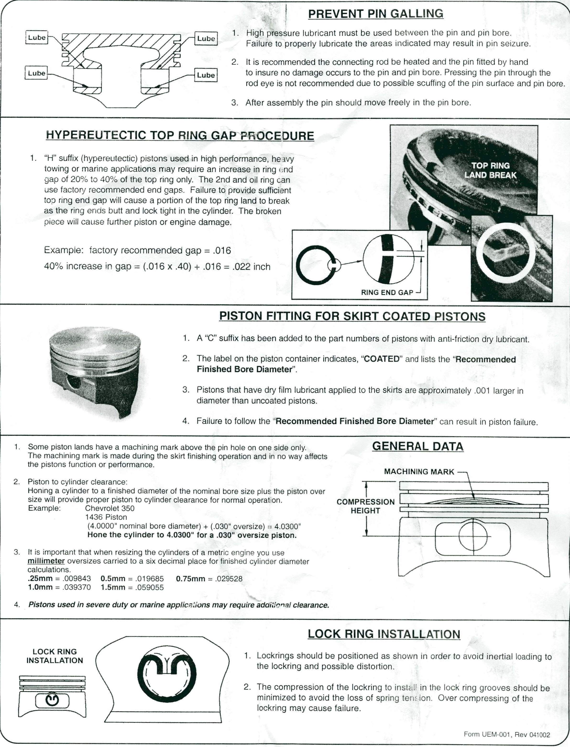

                    The Set of Six (6) Silvolite Pistons for $49.00 just arrived and they look perfectly BeeNib (Brand New...In the Box). I took some snaps of the data on the box end and since there was an interesting and useful installation sheet inside as well ...I scanned that for anyone intending to re-build a 3.4L engine that does not possess that special "Machinist-Engine Building Brain Lobe" and institutional memory of these facts the likes of Ben (WOT-Tech), Superdave, CNCguy and the redoubtable John (Forced Firebird) have lodged deep inside their coconuts. The data shown on the sheet covers more situations than just the installation of this piston set and is worth tucking away somewhere for future reference.
