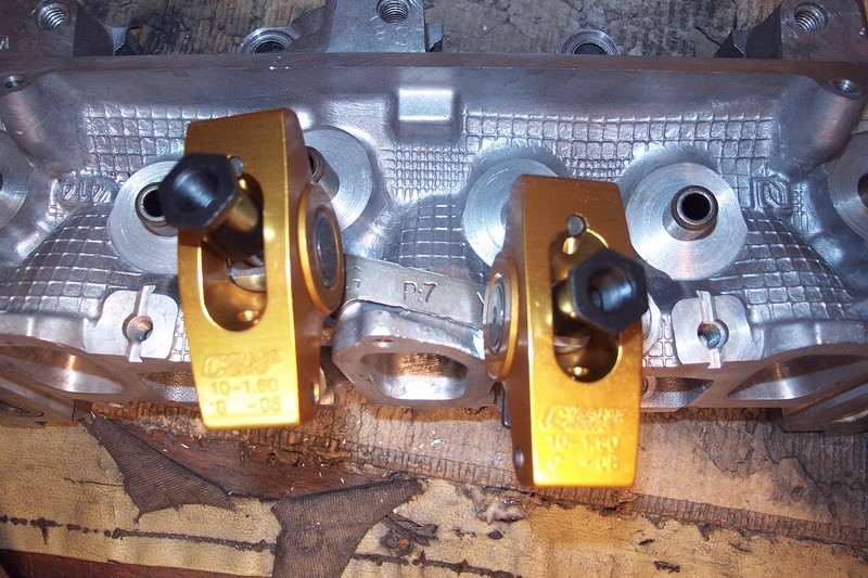

As some already know, the raised ports on the 3500 heads cause a clearance issue with the pushrod guides. I have modified the head to accept the guides and now the crane rockers or any other that requires pushrod guides can use them.
I have 2 sets of the crane rockers in 1.6:1 that will be sent back soon if they don't sell. For those that want to use them on the 3500 heads, now you know they will fit with work to the head. It doesn't create a problem for porting either, since I tested it on what I will consider a boost oriented porting.
