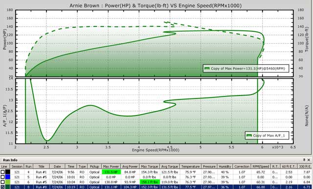

Here it is.
Notice the air/fuel mixture graph. The spike down is the accellerator pump being too rich. You can see where my secondaries at the time were too lean. These two conditions are a whole lot better now. That rich accellerator pump caused a noticable bogg and hurt the lower rpm hp numbers.
There is a spike near the top on the hp chart which was a malfunction in the sensor which you can ignore.
I am hoping to bring that peak hp band back down at least 600 rpm so I have more usable power between 2500 and 3500 rpm by advancing the cam timing. The tuned extractor style exhaust should add probably 5-9 hp overall.

Didn't you have a different dyno readout then that thing? I mean what program is that? I could have sworn I saw another dyno of yours where it fell on its ass after 5k rpm.

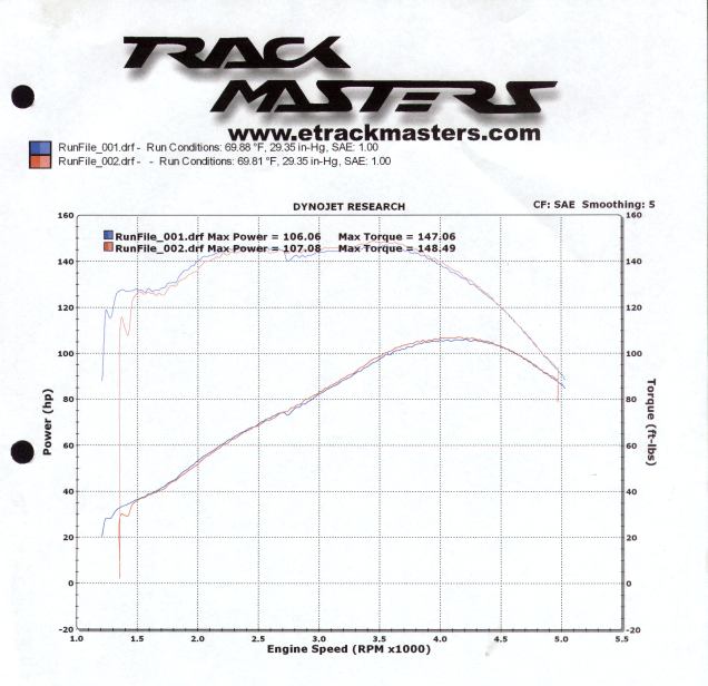

Also the 3.1's dyno more then 110 or so hp at the wheels stock. My bone stock 2.8 did 115 at the wheels through an auto tranny. Most I see for the 2.8's are around 112-117 hp at the wheels. SO for you to do a carb, larger cam, a 3.1 and ported heads and pick up 15 hp is terrible. You never did get flow numbers on your heads, so you might have done more harm then good. You will never know though. But still 130 whp for all that work is not impressive.

Shaun, as usual you are totally full of it.Originally posted by Shaun41178 View PostDidn't you have a different dyno readout then that thing? I mean what program is that? I could have sworn I saw another dyno of yours where it fell on its ass after 5k rpm.

The stock 2.8 dyno showing 107.08 peak hp (as posted on the Fiero forum) does fall rapidly after 5k as did my initial dyno run when I let my foot off the gas at 5200 rpm instead of 6000. (before a tune-up) (see both below)
My 130+whp result is not a bad gain for the limited work done. It will be higher and it is perfectly acceptable for now. Where is your dyno of your 2.8 and the dyno with your ported heads?? Show your sheet if you have one.
There are no ported 3.1 heads on my engine and it has the original cam. BTW I once had a 3.1 rated at 130 hp with an auto and you can bet it did not make 110 hp at the wheels.Last edited by Arns85GT; 01-25-2007, 06:07 PM.Arn Brown
