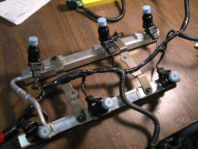

Originally posted by Niteflight View PostDoes anyone have a pic of were the injectors are located on the 3400, and what the harness looks like, thanks a lot.
Um, the injectors are between the fuel rail and the lower intake manifold, underneath the upper intake manifold. I would've thought you'd know that already.
This is a pic of my fuel rail with 42lb injectors and my moddified harness with bosch connectors on it. The part with the red wire loom on the left goes to the main connector, the one coming down from the middle is the MAP sensor lead, and the two on the right side are the cam sensor and coolant temp sensor leads.'97 Grand Prix GT 3800 (sold)
