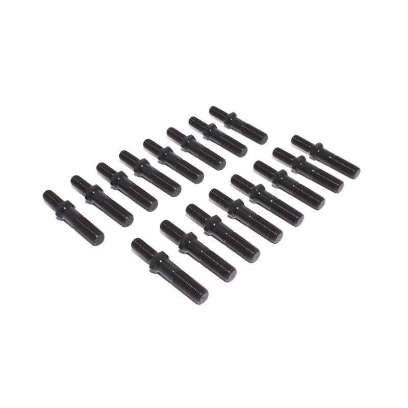

geldartb, I just measured the Ford and 3500 rockers and the center of the fulcrum to tips are the same. The difference was filcrum to center of the pushrod. This means by getting the Crane adapting studs ($16 or so a pair, $96/set IIRC) and some 1.7 Ford roller tips (come with 3/8's nuts/pivot balls), they will work on the 3400 heads. Unfortunately GM changed the threaded hole in the latter years from 10mm to 8mm, and I don't think Crane offered them in 8mm.

Here's the studs I was referring to...
http://www.cranecams.com/index.php?s...&lvl=3&prt=114
GOOD FIND! Now I just might have to get a set of those and will have 1.7 roller tips for my 3500 headsOriginally posted by silvergtjrad View Posthttp://www.lmperformance.com/6342/4.html
would those work? Not sure what length the theads need to be, but these have the 8mm base threads and 3/8 stud threads
EDIT: Also those list with Comp for $96.48 LMP sells them less than the Comp online store by almos $30. You will have four extras, too.Last edited by ForcedFirebird; 07-28-2007, 09:03 AM.
