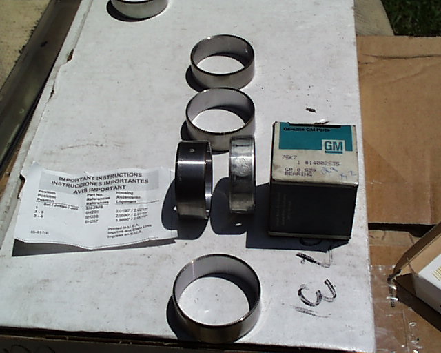

Pics of cam bearings - SH290 set vs. stock GM cam bearing. Bearings install no different than stock 60* bearings, but it is advisable to gring a small slot/groove in the front of the forward most bearing for cam gear oiling. Most OE bearings have the groove/notch. IF memory serves me correctly, the oil hole should be at the 4 to 5 o'clock position when viewed from the front of the block.

Damn, I wish I knew that when I did my bearings... I used stock ones. Oh well.
Ok, the SBC fill up the journal, but is the cam shaft as wide as the journal or not?sigpic

Journal is as wide as the SBC bearings. I already installed mine before I found this out. In fact, the same cam bearing install/removal tool I have works on SBC and 660's.Originally posted by IsaacHayes View PostOk, the SBC fill up the journal, but is the cam shaft as wide as the journal or not?
