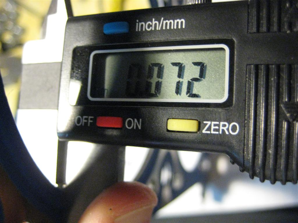

Makes sense that it compresses but I wasn't expecting .020". Stock 3400 is .060". They sell .060" thick gaskets. Thats a recipe for piston to head contact at higher RPM at their advertised .051" thickness.
I measured .065" inside the fire ring as well on my new 3900 gasket.

I bought a set of Cometic head gaskets for a 3.4 from Ben in .030 thickness. Before installing they measured about .036 to .038 depending on where you check. After install I show .031 to .032 on a few places that I can get to the block and head. Seems to be really close to what they say it should beOriginally posted by CNCguy View PostA used gasket from an '06 3900 measures .055" with micrometers in the uncoated areas. The middle and outer layers measure .039" and .008" respectively. Coated areas around the water passages and head bolts mic .060"~.061". A new gasket would probably measure thicker in the coated areas. Installed thickness is probably in the .057~.060 range with .055" being the minimum since there is no way the head bolts and aluminum heads could generate enough force to displace the metal gasket. I will see if I can measure the installed thickness on my engine the next time I drive the MG to work (when it quits raining).

Guest repliedThanks CNC, I just got off the phone with Cometic and the rep stated the advertised 3.9 gasket is based off O.E. specs as close as they can get .051-.052 and that the new uncompressed gasket would be thicker.Originally posted by CNCguy View PostA used gasket from an '06 3900 measures .055" with micrometers in the uncoated areas. The middle and outer layers measure .039" and .008" respectively. Coated areas around the water passages and head bolts mic .060"~.061". A new gasket would probably measure thicker in the coated areas. Installed thickness is probably in the .057~.060 range with .055" being the minimum since there is no way the head bolts and aluminum heads could generate enough force to displace the metal gasket. I will see if I can measure the installed thickness on my engine the next time I drive the MG to work (when it quits raining).Last edited by Guest; 09-28-2010, 11:36 AM.

Guest repliedI don't know that. Looks like you've got a fat gasket. Seriously it appears you are measuring over the embossed sealing material which will easily compress when the heads are torqued down. The literature I've read on multi-layer steel headgaskets indicate that more than one type of metal is used in the composition of the gasket and that one has a spring like composition to allow for some compression when the heads are torqued down on it. I measured an area that is not coated and although I could be wrong I'd expect the number I measured to decrease some under head bolt torque.Originally posted by SappySE107 View PostYeah and we all know the stock 3400 is .051" thick too.

Guest repliedI said if they confirm that the stock gasket thickness is .051. That's what they have listed for the gasket they sell on their site, it doesn't state whether it is stock or not. If I call them and they say it's the stock thickness then it's confirmed. They list the same thickness for the 3400 gasket.Originally posted by SappySE107 View PostWhere does Cometic list stock gasket measurements for the 3900?

Guest repliedGot the crank back today. 3.555" stroke. I also got a chance to check deck clearance again and this time I measured both sides of the piston inboard and out while pressing down on one side. I measured .031 and .049 to come up with .040 deck clearance so with what has been previously been measured we can be sure the quench area stock is at least .100 unless Cometic confirms that the stock gasket thickness is .051 which is what they list the 3900 gasket the offer as. From what I've read on MLS gaskets to date they do compress a little which is what accounts for some of their superior sealing characteristics.
