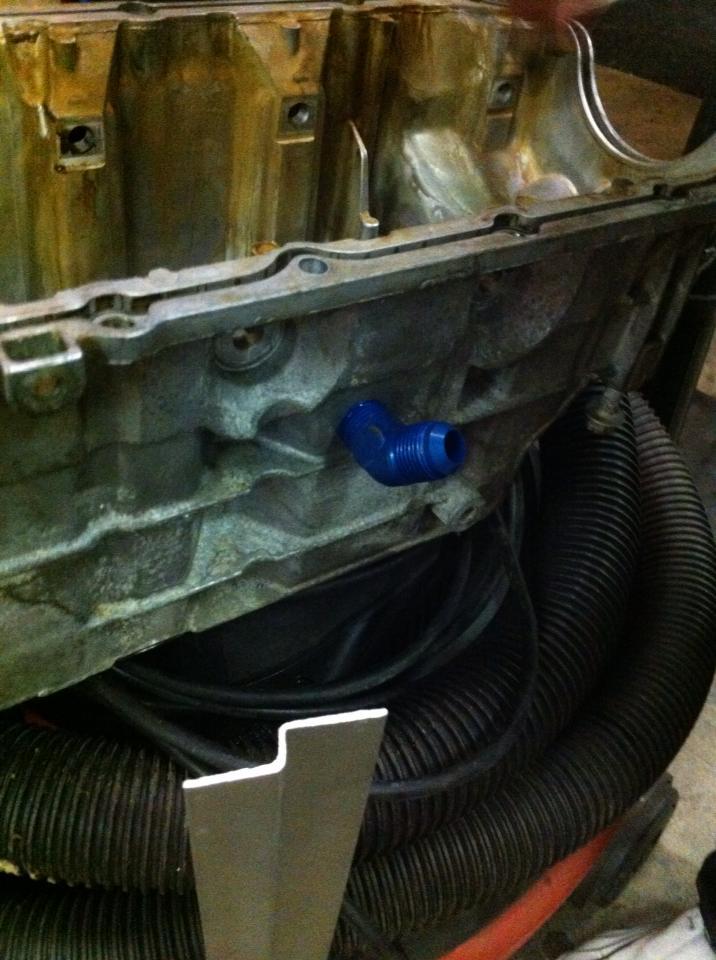

Finally got around to putting my braided hoses together:
Fuel hoses; return line comes from the schrader valve for now to the FPR
Oil drain
Oil feed from beside oil filter
