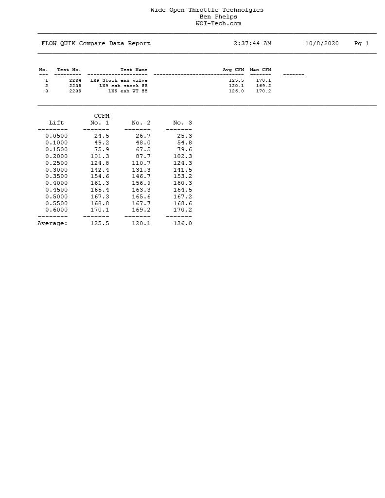

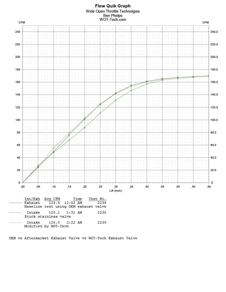

    We used to have copies of the OEM valves available, but these days they are all based on a different design for some reason, which hurts flow. I was able to modify this one to be back to stock so its not hopeless, but needs to be addressed if you want to keep performance. Based on a stock 3500 head. Supporting wot-tech is greatly appreciated.
ID:	426551 Click image for larger version

      Testing intakes now Bit more work though since the 3400 vs 3500 port design is significant. Need to check both with the same valve work.
